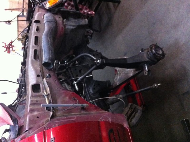

    here are some pics from about a week ago, old bump cans have not been cut out, and new front hangers as you can see, and the tundra axle as well

    front new kit, with modified solo spindles for lower uniball

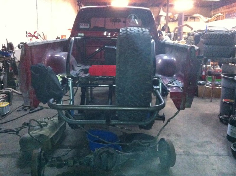

    and dual spare tire carrier, the fram is boxed, the bed itself will be reinforced, and new shock mounts will be made to run the shocks outside the frame.

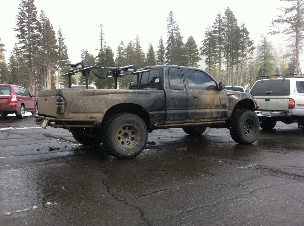

    No thanks. I'm happy with my tundra axle :cookiemonster:

    I basically rebuild the entire long travel rear end from what was originally on the truck when I bought it. I kept the shocks inboard when I did the tundra axle because I didn't want to cut out and rebuild the bedcage which serves more purposes than just a shock cage. For my purposes, shocks inboard and bumps outboard works just fine.
