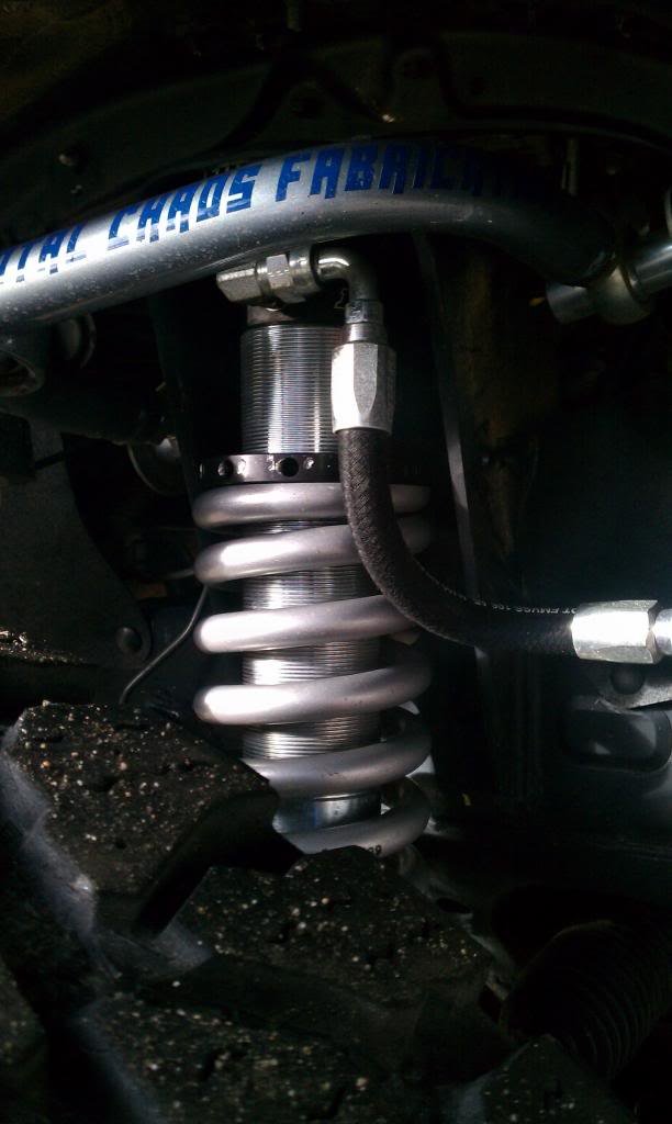

    I need the help of the best when it comes to c/o's
    I currently have 16" #600Ib springs in Fox c/o's
    I have more preload than I hoped for.. (I guess plate bumper?)
    just over 2" preload
    Im hesitant to crank them anymore, but want a tad more lift up front.
    The ? is can I swap in some 18" #600or#650 coils to have less preload?
    Will I have problems with Coil bind or any other issue with a longer spring:notsure:
    Much Thanks TW!
    its on a DB lift btw:eek: :crapstorm:

    I have 18" 650lbs coils on my foxes. I had the 16s and ran into the same problem. MUCH better now. :) i only have an inch and some change of preload.

    I think only spindles or even less preload would cure that.

    No. That wouldnt change it. Im getting the LSK 3.5" lift spindles and that will make the uniball perfectly level. Pretty excited about it! Nice thing is, you dont need lift spindles if you have spring under to fix the uniball angle because it sits lower than my allpros. Since my stupid allpro lifts sit so goddamn high, i have to crank my shocks more than i like thus causing the bad angle on the uniball
