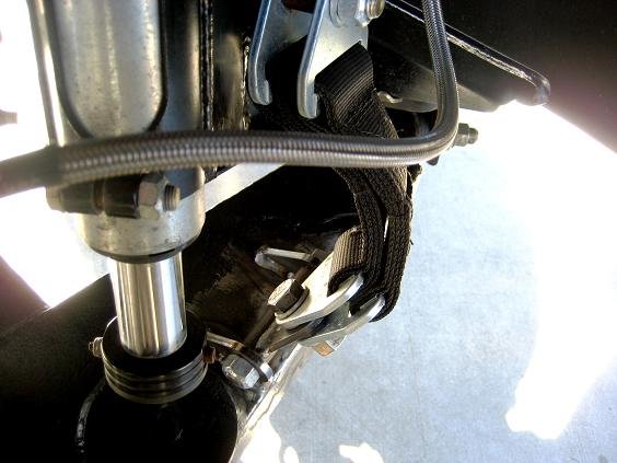

    So I never cycled for limit strap squish when I first put the front kit on, then it realized the buckles might bind into each other at full bump, I did a coil swap and cycled the arms when it was torn apart and it was for sure an issue. Thats what i get for mounting them so far up the arm, that and too much stretch. oh well.
    Here's my band-aid solution. Running it.

    Simple, yet effective. Nicely done:thumbsup:

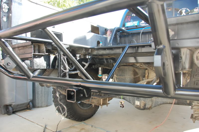

    KR put a hitch on my tire carrier/rear bumper:
    not as strong as the stock hitch but I've yanked class ones without a problem
