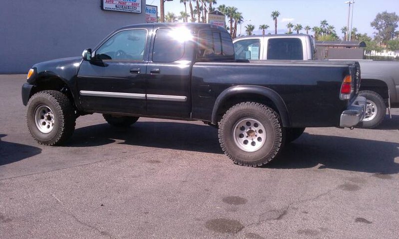

    Cantilever?

    Is that a 2nd Gen Tacoma Matt? Can't tell exactly. :cool:

    It's the better platform for LT a first gen extra cab most likely a 3.4 V6 :)

    1st gen Tundra actually

    so sleeper :cool:

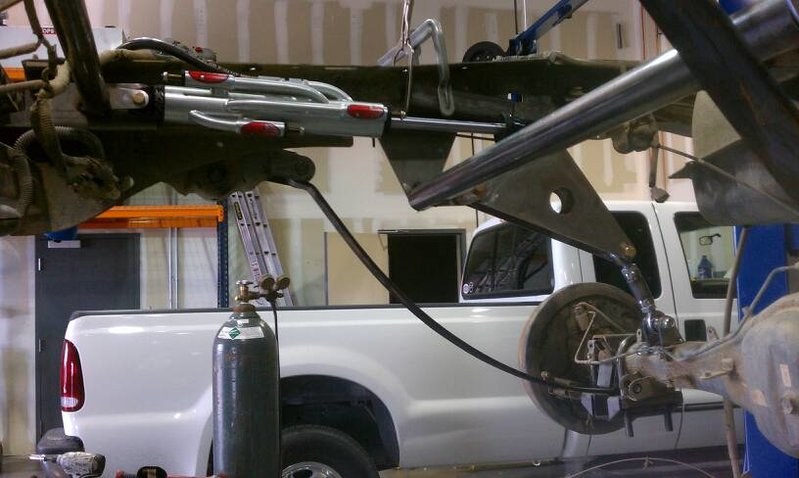

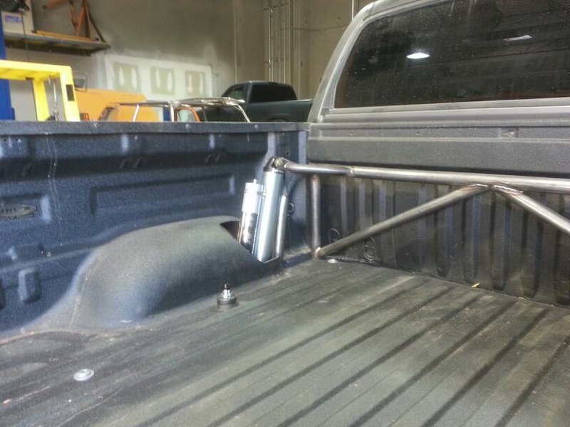

    Awesome setup! Get away from 1 to 1 on the shock ratio and slow that shaft speed down.

    what brand shocks are those?

    ADS

    I do those too. :)
    Thanks. So far he is pretty happy with it. I set it up with a linear rate of 1.8:1
    ADS Shocks. They are my choice brand to deal with.

    That's the great thing about cantilever you can keep it linear, really the only way to do that with leafs,

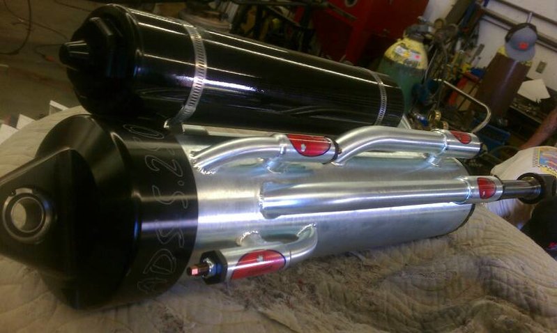

    Heard all great things about ADS, don't think make a huge bypass now? Like around 5"?

    Yup. 5.25"........
    Their customer service is amazing. They now make the short body shocks for all my Toyota LT.

    Good god that's huge! Anyone running it yet? What's the shaft size?

    Read somewhere it was a 1.25" shaft
