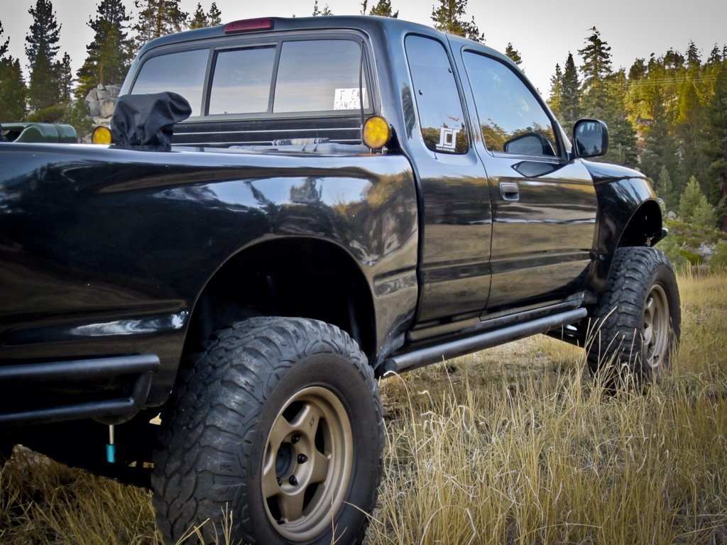

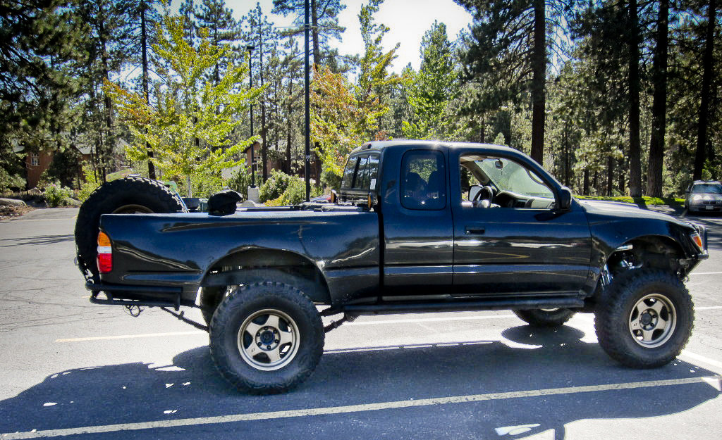

    ...too much shit to list.
    Front def looks high...and the rear looks low. Mine is 600 lb 16" spring with tapered spring retainer. About 1/4" of preload on passenger side and about an inch on the drivers side.
    17951469-8792-445E-9D96-95309210DC0D-405_6d135e99b3b0be73f91f9f2f7dc31151ff4a8ce5.jpg
    319A82A2-4AC6-41E9-B86C-0A56C039C567-593_bfd5c8112c68e4376bc188e6656c9177d526e78e.jpg
