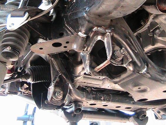

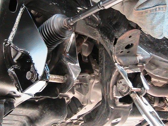

    Finally did this, wasn't fun and pretty ugly but better than welds on the back of the lil tabs. Super awkward mounts to try gusset. The front mounts needed it for sure.
    Yes I have a water pump leak.

    Fabien...you got a leak :p
    Boxing in the cam tabs is a nice touch :thumbsup:

    Looks like your rack bushings are shot. You can see the whole rack shifting and I'm willing to bet the creak is the rack sliding on the rubber bushings. Have you ever replaced them? Energy Suspension and TC both make replacement set. Not terribly difficult to install either.
    Curious, where'd you get the little boot to cover the shaft on your bump stop?
