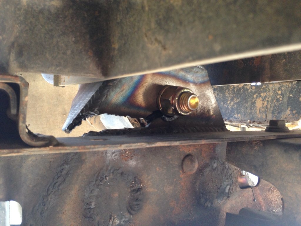

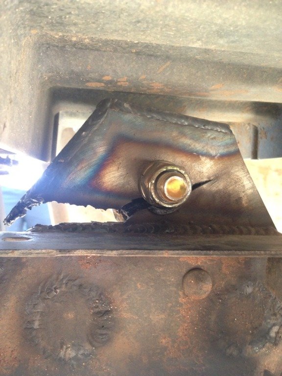

    Looks like the weld failed, not the part...

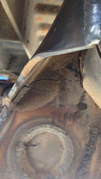

    If the crack originates from the location shown in the last picture (as far as I can tell this is the case) it appears as if the weld that initially broke then traveled up towards the upper shackle bolt would have been an Engage weld unless the shackle mounts come completely un-welded and just folded, which I'm not sure.

    The engage weld broke which caused the material to pull away from the weld to frame. One side fully separated the other just cracked
