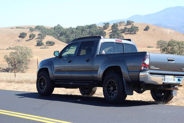

    Those wheels really make those tires look good, what are those?
