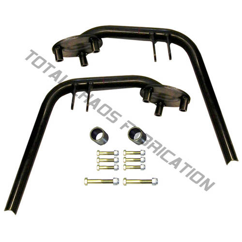

    having the b-pillar out back is proving to have its own challenges but its been fun. Got the A tucked in there pretty tight though

    if it were me i would build something similar to what tc has then run a cross member over the engine to support the hoops...fairly cheap and easy fix before you can do a actual engine cage

    this is what i was talking about anthony

    Thats a good idea...i wanted the tc hoop but i doubt the bolt holes will line up now lol

    Don't let your shock bottom out. 90% of that kind of damage is from poor shock set up

    It also has to do with the shitty design of that coil adapter it has no support just a piece on 3/16 with some tabs. I was disappointed with it when we installed Jordan's LT kit.

    How hard would it be for you to make be a beefier adapter? Because I also have the engage one an its bent. Or is it to late?

    I am going to cut my coil bucket out when I finish my engine cage in the next week or two, I'll sell you my Camburg adapter

    Oh thatd be nice. I'm just not sure what I want to do yet. I might do a shock hoop with the 8s and ditch the buckets but we will see.

    Yeah I thought about plating the top and connecting to an engine cage but I think removing the coil bucket is the way to go

    Ya, that doesn't help either. All my kits come with a billet adapter that is about 1" thick overall.

    Similar to TC?
    Mine is 1/4" plate with a more than enough support
