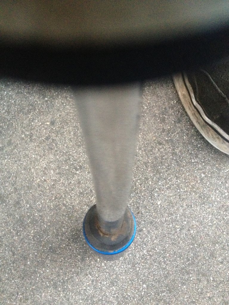

    as promised... so should i:
    a) buy a new piston, wear ring and shaft, put it back together and run it till i find a new front kit
    b) save the money i would spend fixing it, take the valving from the broken one and run a flutter stack or some kind of combination valving and one shock at each front corner until i get a new kit (both shocks at each corner are valved different... one with quick springy rebound and a light compression, and the other with harder compression and slow rebound... the shaft that bent was on one of the stiffer ones)
    Luckily the inside of the shock body isn't scratched and all the seals seem okay, but I'm really ready to ditch torsions and balljoints... what to do?
    EDIT: nice, just found a pretty solid little dent in the shock body about 1/3 of the way up, fuck. looks like a shock a corner it is then. thanks though!

    Is that a 2.0 or 2.5 shock? Id say ditch it and go coilover.

    Its a 2.0. I agree, just having trouble finding a used tc kit or something comparable around that price
