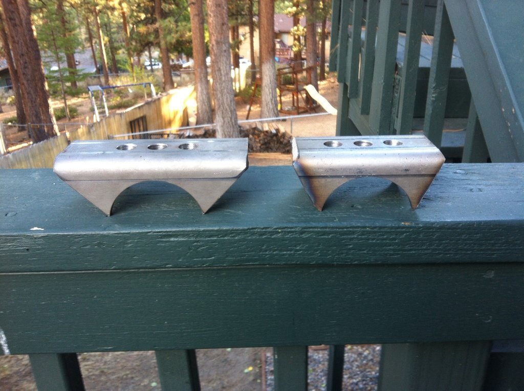

    just giving you a heads up if you didnt buy their spring plates, you might have to drill out the holes in the spring plates you're using. i just bought the TC ones and theyre cut for 9/16 rather than 5/8.

    AP plates are sized for 5/8ths, not sure why they ship 9/16ths with the plate drilled that big? The fit is much better now and when torquing down the bolt doesnt walk around in the plate hole...

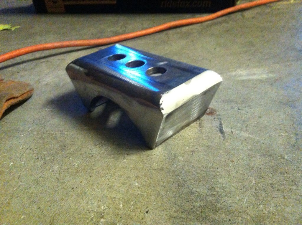

    The AP plates SUUUUUUUUUUUCK for LT. They are just way too big and wouldn't work right with the spring pack fully arched. I had to cut mine down and do all kind of mystery shit to make them work.
