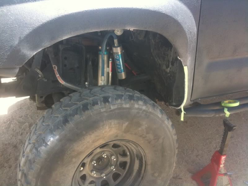

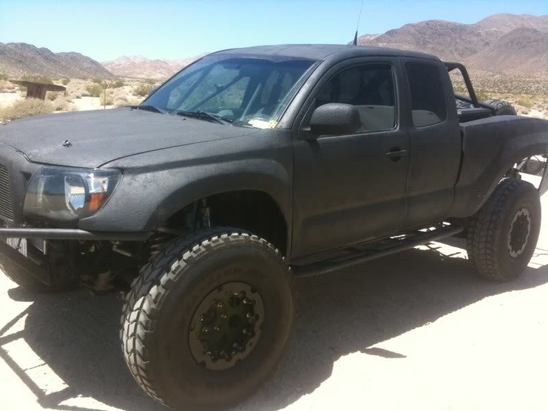

    You can get the Military BFG's for $150 each, 75% tread or better. Groove them how you like...this will be my next set of tires for sure. The drawback is that they are 16.5's, but I like my TWF beadlocks a LOT. Maybe not the best street tire/wheel combo ever, but super tough. I haven't had a single flat (with the military goodyears) or bent/broken rim with them in 30,000 miles (most of which are dirt miles). In fact I'm redesigning my bed cage because I see no reason to carry two spares anymore. Keep in mind I went through 8 KM2's and several rims in 7000 miles before getting these. I am not easy on tires.
    http://www.trailworthyfab.com/BFG-Baja-T-A-37x12.50-16.5.html
    EDIT: I am at 91" outside of tire to outside of tire. 3.50" backspacing, 1/2" spacer on each side. 37x12.50x16.5

    1/2" spacers take care of it. I would also do longer ARP wheel studs though, the stock lugs are pretty short anyway.
    Also, 16.5's have a 15 degree bead. It's flatter than a "standard" safety bead tire, but very common in the heavy equipment and trucking industries. The reason it is more flat is to support a heavier load. Big rig tires will also pop a bead pretty easy when aired down compared to car tires. Another benefit of this design is you can change the tires yourself. No need for a tire machine, just a breaker bar. Easier than a dirt bike tire for sure. The TWF beadlocks are also capable of being changed on the trail, just need a 3/4 socket!
