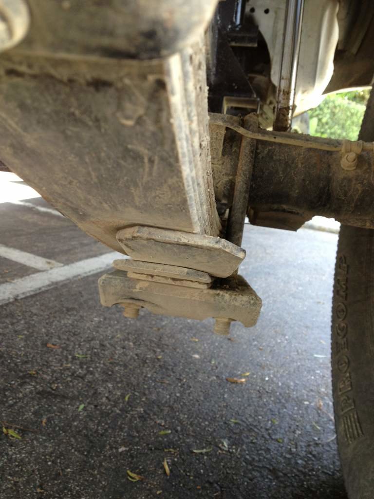

    What do you guys think of this...obviously it's not supposed to be like that. y3a2aby2_f5085a1b21c8263659711fda19a96f0353424dd4.jpg

    to me it looks like your U-bolts arent tight. you can see less threads on the inner bolts

    we did a aal redo on a truck over the weekend with a similar issue. it was the center pin not long enough to get a tight squeeze (the oem one was too short). i suggest tightening that up first.

    Could this possibly affect the pinion angle of the 3rd and create some growling/grinding noise?

    Pinion angle will create a driveshaft vibration.
    Another thing to check is the rear wheel.bearings. when they go the make a growling noise that varies with speed.
    Also, looks like someone didn't torque the u bolts. Something that gets overlooked alot. U bolts stretch alot and most guys don't use a torque wrench
