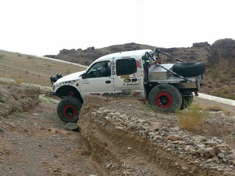

    Yeah I know it looks tall. About an 1" on driver side and about 5/8" on passenger side, that'll be changed up soon tho.

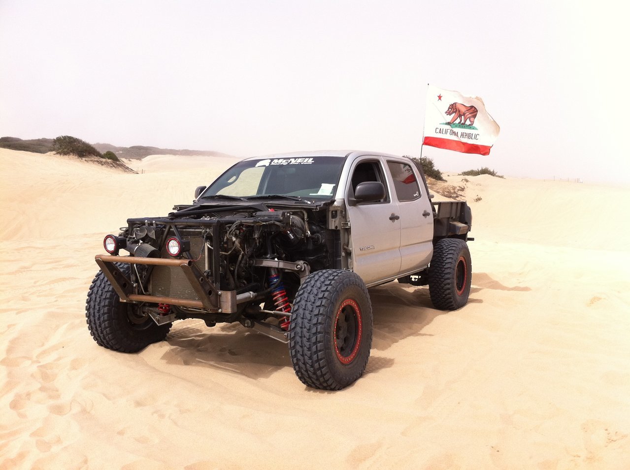

    Fixed
