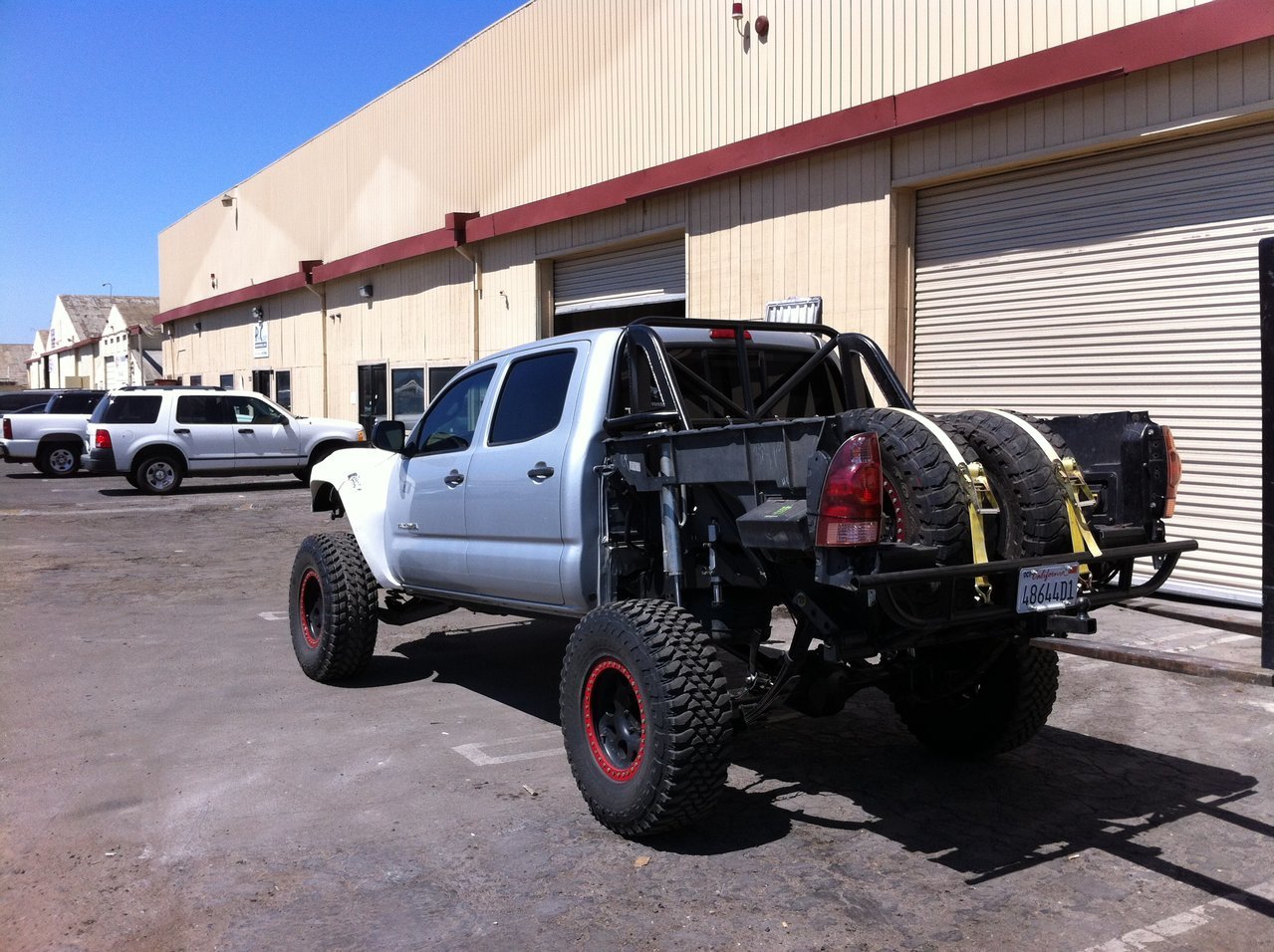

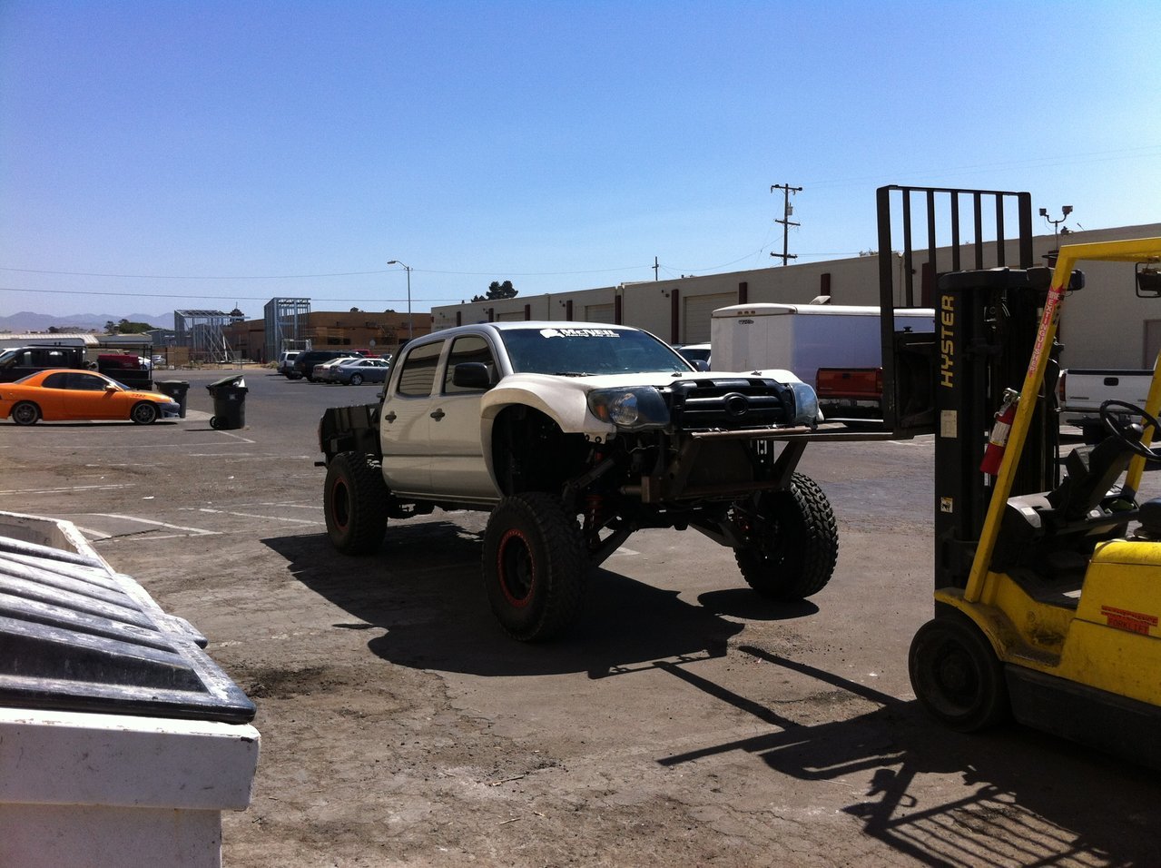

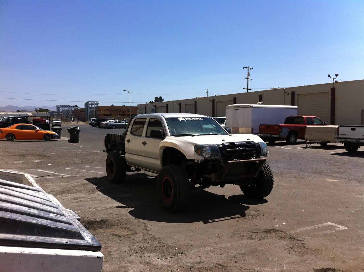

    Took a short lunch and got to play with our fork lift :D

    X2 :drool: :drool:

    Drool x3

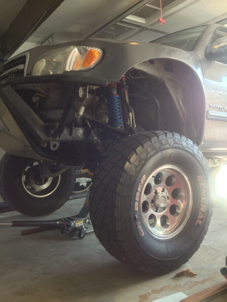

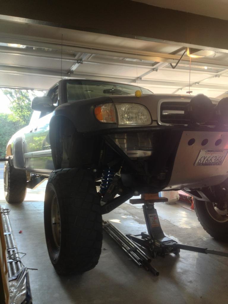

    Just a bit of droop ha had another few inches but my jack and 2"x4" didn't

    HOLY DROOP! ^^^
    plus your linked out back??
    :drool: damn man. sick truck
    as jason said..should be able too as it would have to be an ARB or Detroic or Lockrite.
    its also 3'' wider :cool: or so.

    damn.. haha. thats some travel.
