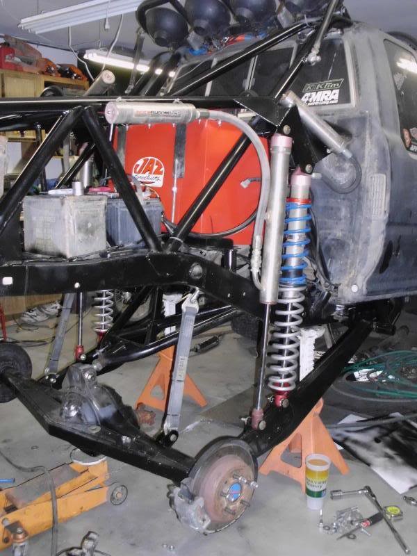

    I'm running a 14" c/o and an 18" next to it. Both show 1/2" of shaft at bump. I worked with what I had though... At full droop I'm not extending my 18" all the way. Granted, I'm not bypassed but I set it up so that I'd be using the full compression on a bypass, I just wouldn't be getting that last 1"-2" of extension out of the bypass. (center mount isn't finished, I have a full vertical back brace tieing into the truss... That's why it's not painted. I wanted to wait to finalize that till I had the driveshaft built so if I needed to rotate it for pinion I could relatively easy still at this point.)
