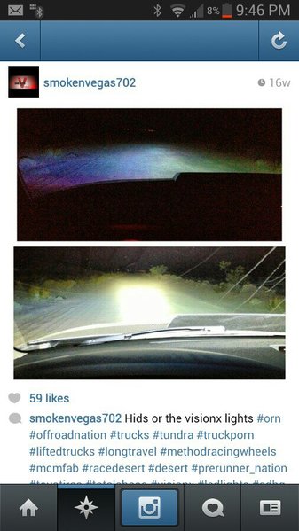

    exactly what my set up is. HIDs up top above the B-pillar to prevent hood glare, and LEDs up front to flood the immediate surroundings.

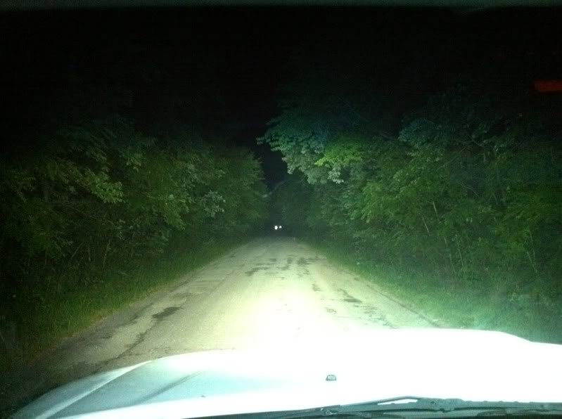

    I love my LED light bars. The throw is plenty for me to go 50+ MPH in the wide open, but where it really excels is in the uniformity of the light and the wide spread. You can see every detail in the dirt and the wide spread (left, right, up, and down) is helpful when going up and down hills and around corners.
    Plus the low profile mounting = less wind drag; and less wind drag = better MPG, quieter cab, and still fits in the garage.
    F9FB05BF-BECE-4BF5-88BF-B380A13F94A9-349_032a8cf53923c9abc3a34b52f1236d02363d707c.jpg
    It does give some glare, but it's not bright enough to be distracting or affect the driver's vision. Looks worse in the picture than it is in reality.

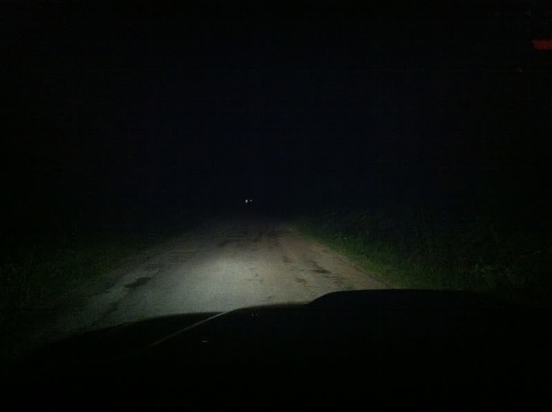

    Here is the same spot with the stock headlights for comparison:
