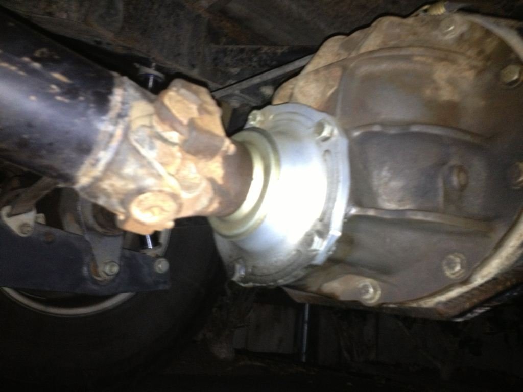

    Just tried taking a pic of it in the garage but my phone is being an asshole and you couldn't see shit but here it is

    fancey looking!
