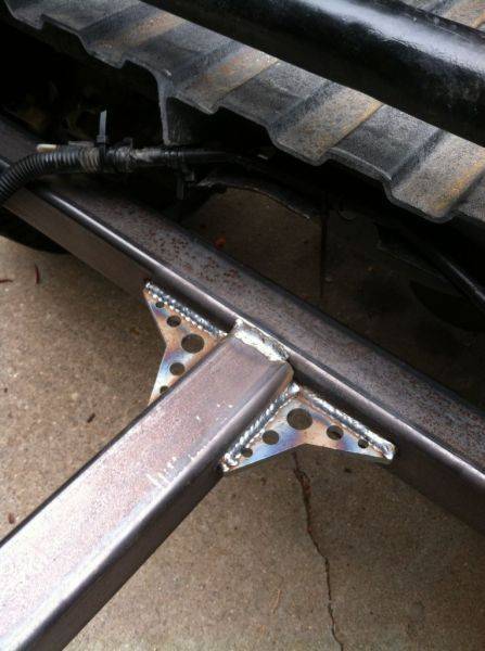

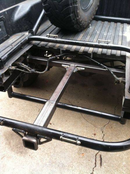

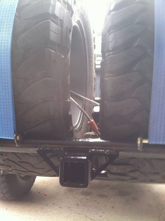

    how i ended up doing the hitch:
  8. Sep 20, 2013 at 6:26 PM
    anthony250f
    anthony250f Well-Known Member
    Feb 18, 2012
    #73066
    16,776
    Anthony
    San Diego, CA
    2008 dcsb trd offroad 4wd
    its welded now...connects to the gusset...then i ran out of gas....

    i didnt weld the corner gussets..jordan (santabarbarataco) welded that part...but i did the other stuff.

    Looks damn good! My only suggestion would be to wrap a tube (just a smaller tube, like 1.5" or 1.25" .120) under the bottom of the end of the receiver instead of just the side gussets. Lotta stress pulling down on that hitch.

    Turned out nice Anthony. I'd take Jason's suggestion though, the disadvantage of tube to box tube is you don't have nearly the contact area for welding as box to box.
    if you remember the picture i sent you, i have 4 of those 90* gussets, as well as two tube braces and a plate style brace on top. that was all in order to avoid having a tub under the receiver, to help with clearance, but with clearance not being as big of an issue, that would be a nice easy way for you to go.

    ^ Exactly.
    Doesn't look like clearance really is an issue anyway because of the vertical spares. Those look like the lowest point anyway.
