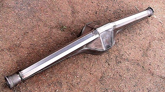

    Did some more plating on my econoline housing.
    I'm happy with it and it's getting me back into do work mode but I'll prob just get a nice aftermarket fabricated one next time.

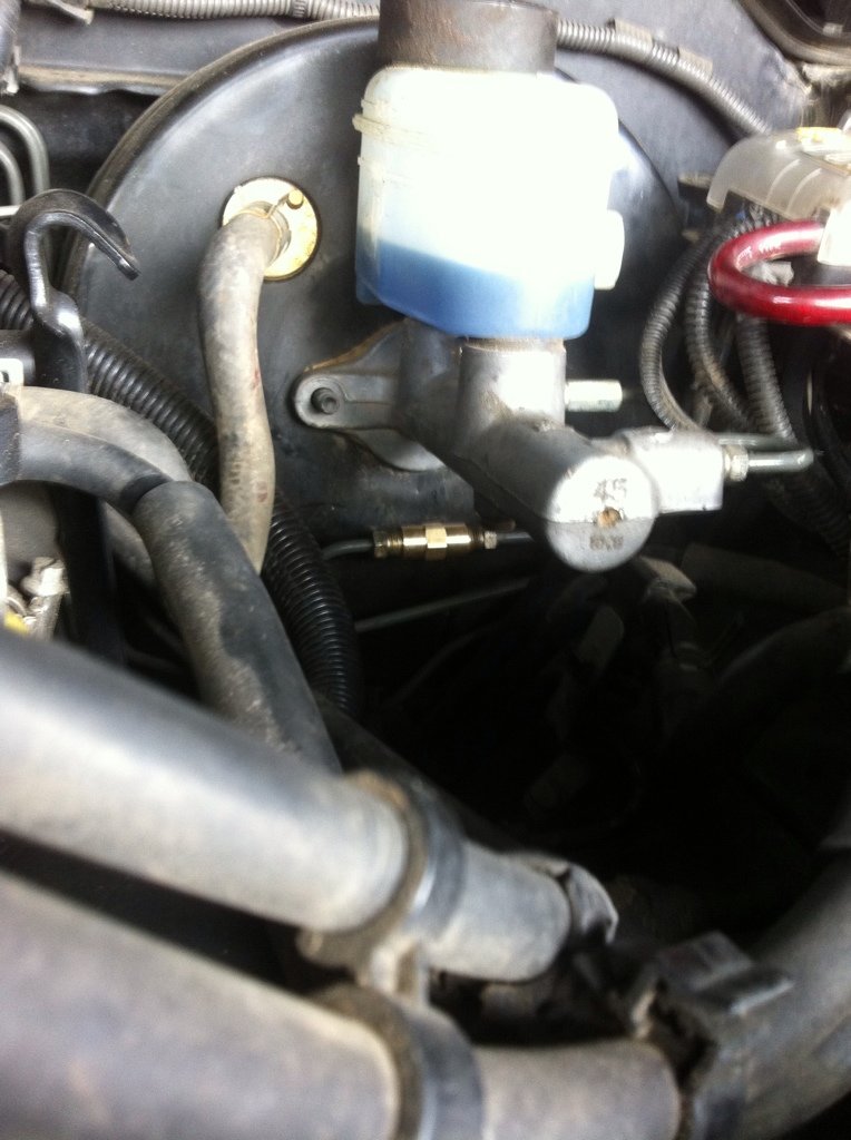

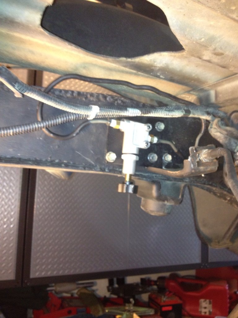

    Yes under the receiver. And I see no reason why you wouldn't be able to access it. I can reach mine just fine.
    Yep, one line is pressure line, one is a return back and puts more bias up front. I removed all that shit and just kept a single line in to the proportioning valve and a single line out to the rear brakes.
    8E9604D0-6195-491F-A264-4CD804469F41-257_b52e4708035002ce708b39170c489bb839ae084f.jpg
    I have the Willwood proportioning valve
    If I were to do it all over again, I would have gotten the one from FROR as it has all the correct metric -> standard adapters. I had to do some ghetto shit to get mine to work.

    Ill mount that bitch under the hood. Thanks for the pic. Now I just need to figure out what line is what.

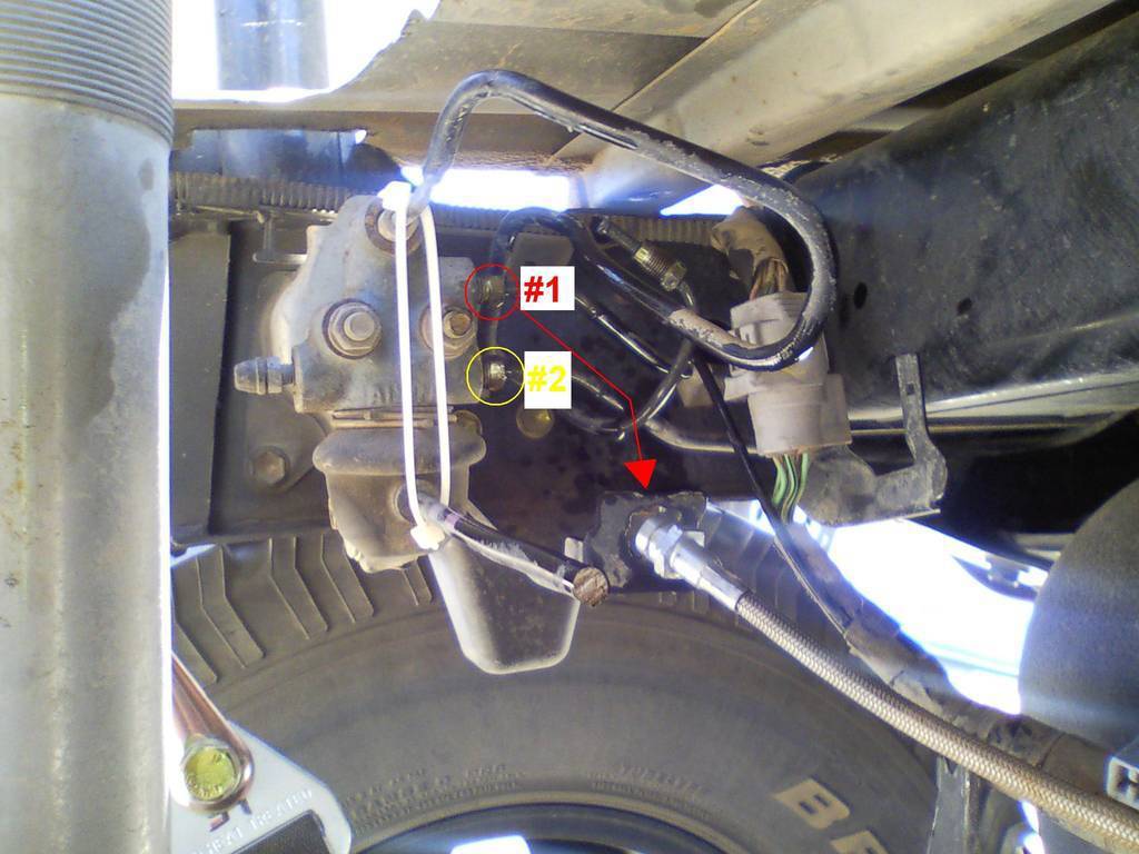

    Stolen pic from JD's build.
    Line 1 you keep, line 2 you remove (return line)
    Yours may be different as my truck came with ABS. But....for mine
    Before, the return line came in here:
    FCB3EB37-7D57-4F2E-9EE4-EA86786A9F9B-257_6694ebfdaddc3ae9739ad2cff5480a8b140b011e.jpg
    After:
    137FC908-3608-4B9C-A643-C9E52A159C16-257_3feea5700c8714de41c671bb05e0c8b3656b4828.jpg

    So on mine, that rod is just cut off, does that mean most if my brake bias is on the front?

    Yup. Switch it up with a zip tie...you'll be amazed how much better your truck stops.

    Just zip tie it so the rod gets pushed in?

    Look at the picture I posted of JD's with the zip ties. Zip tie it upwards
