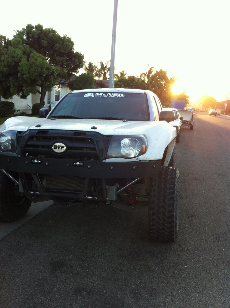

    Couldn't help myself had to post a progress pic of the new front bumper just need to mount facy pantsy skids and paint

    So what's the point of the flat fairing on the front bumper. you see it on tons of trucks, but i've never been able to figure out on my own what it's function is.......

    Because Trophy Tacoma

    Trophy trucks started using it for better aerodynamics at over 100mph, and since everyone on TW does that speed in the desert they need it too:rolleyes:

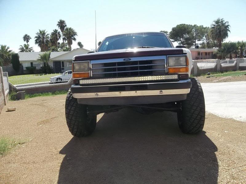

    LOL, make fun of me all you want but I still say Ford was ahead of the game as they offered that TT aero package as standard equipment in '91!!! And so therefore, that's obviously why I kept the old school front clip and bumper rather then going to the conversion and some big prerunner type bumper! LOL
    Now if only they'd put a Toyota 3.4L rather then the gutless ford 4.0L in this thing back in '91 I'd be stoked!

    For me its just to clean up the front end and hopefull cut down a little on my the amount of air my parachute size one piece catches. I'm still going to drill the mini fenders

    My 90' ranger has the same "race parts" lol
    except I'm rocking the gutless 2.3
