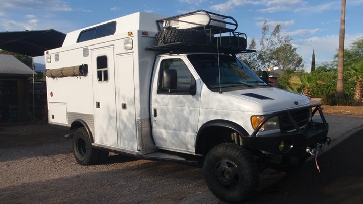

    TTB is nice and all, but my next rig is going to be center mount A arm 4x4:
    hopefully after I get my MBA, CPA, CFE, and house, i'll build one of these, along with a 4x4 Ambulance converted to expedition tow rig.
