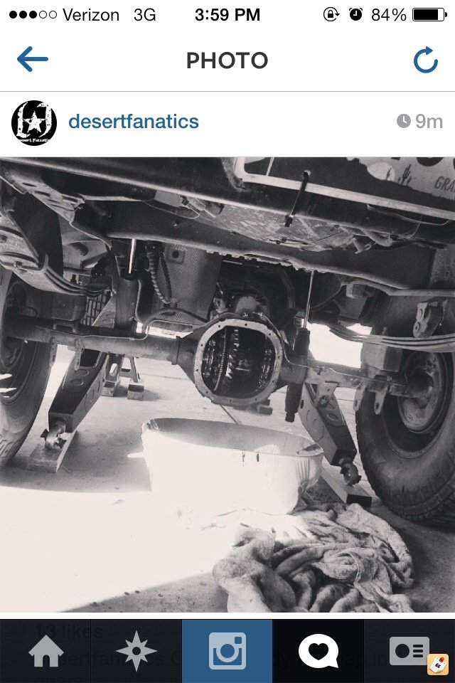

    and stock shocks hahaha

    isnt the diff facing the wrong direction too?

    No ubolts ?

    Az license plate?

    Yep

    kinda looks like a ranger (hard to tell) but the Ford 8.8 rear axles have a removable diff cover I believe

    Looks like a 97-03 F150.

    still an 8.8 tho

    Isnt that just the diff cover?

    Looks like theyre just starting to locate the link mounts. You just leave the leafs on at first so you know where to position the axle, driveshaft etc...
    Diff cover is off to drain fluid for welding.

    He said he's gearing to 4.56 an the links are being used as traction bars currently.
