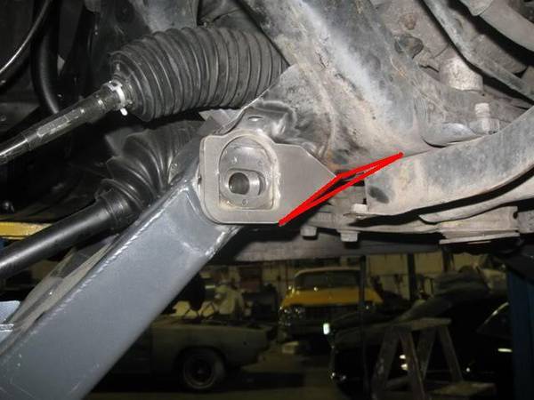

  2. Jul 14, 2011 at 11:43 AM

    good loard!
    is it broken? looks like they're pushing it.
    also, do you have any imput on the bent lower control arm mount issue. i feel like you've probably bent quite a few of those :D

    I really don't think its a big deal just grab a sledge hammer and a piece of pipe. Put one end on the tab and beat the crap out of the other. Then go to an alinement shop and get it straitened out. I doubt you bent the arm its self

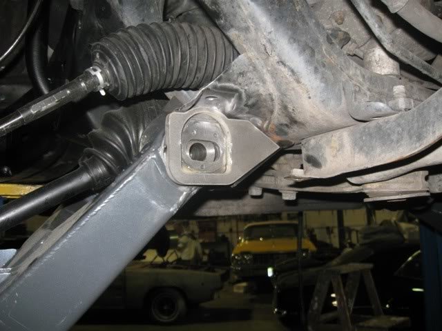

    That was being pushed into SCORE tech inspection at the 2009 Baja 1000. What you see is exactly how they designed and built it.

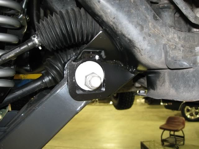

    My LCA mounts are reinforced with 3/8" cold-rolled steel welded to the cross member. These plates also serve as my alignment tabs and should never give me issues.
    There's 8 of those on my truck -- 1 for each mounting tab.

    oh yeah, i'm sure the arm isn't bent, and bending the mount back should be no problem. i'm just thinking about how best to reinforce it afterwards.
    nice. i would normally use this as an oppertunity to get the kit from total chaos, but i have another wheeling trip this weekend, and would rather have it fixed before then. i don't have any 3/16, but i have a ton of 1/8. i figure that will be enough since my truck hits the rocks a little slower than yours :rolleyes:
    i'm also thinking about something along these lines for a little extra. beneficial, or is a gusset a waste of time in that location?
    i would love to make a removable skid/cover for the alignment bolts themselves, but i haven't figured out a design for that yet.

    An extra gusset can't hurt. Mine have held up to a high-speed impact that mangled a gusseted spindle without budging, so for now I'd say what I've got is adequate. :)
    As for protecting the mounting tabs, BudBuilt skids already have that covered.
    From what I've seen, Bud is the only vendor that protects the critical stuff like that. I have no idea why nobody else has stepped up in that area but it's the reason why I'll only run his stuff to protect the underside of my truck.

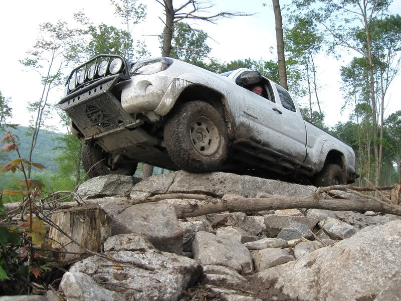

    People love to run bumpers and skids that narrow from top to bottom like the trophy trucks. TTs are like that because the suspension pivots at a center mount. On our trucks, that kind of setup is for looks (and bros) only. A wide bumper and skidplate is needed to protect the radiator and suspension mounts.

    i've got the wide enough bumper. i'm actually going to be taking it off and reinforcing the entire thing shortly, but you're right about the skids. it's a ton cheaper for me to adapt and strengthen the current skid than get a bud, but once this one is toast i'll be getting the rest of the buds. got a bud built gas tank skid coming my way next week, but that doesn't help the current situation :rolleyes:
