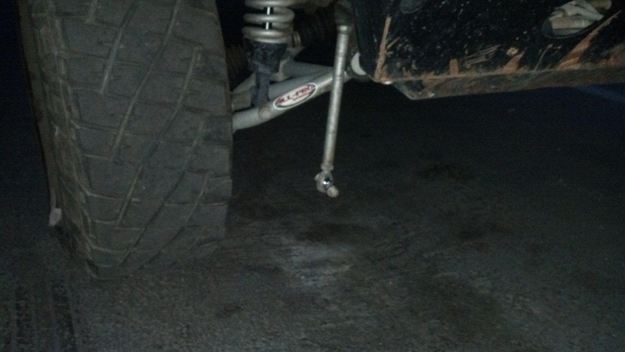

    HaHa..
    I've broken 2 of these guys, luckily both happened on the street and not on the dirt :p

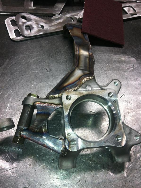

    thats slightly different haha, but since you posted it all pro or someone desperately needs to design a gusset or tab to double sheer their heimed steering setup off the spindle. I also had issues with the outer bolt coming loose or rotating over time and wearing that angled bolt down when I had my AP kit. Luckily I never had one sheer but I think it was part of the reason I've gone through 3 steering racks.
    Great concept, poor execution IMHO
    Edit: SDHQ Designed and Built spindles to properly run a full heimed steering setup :thumbsup:

    Fuck I want that

    There's been a few peeps out there who's promised a fully fabbed 4wd spindle but nobody has come through yet aside from a few one off sets :cool:

    Dirt designs and solo both make fabbed 4wd spindles.

    Solo's are only for their kits aren't they? I would guess the same for dirt design as well. I think they are meaning a fabbed spindles that you can throw on basically any Tacoma.
