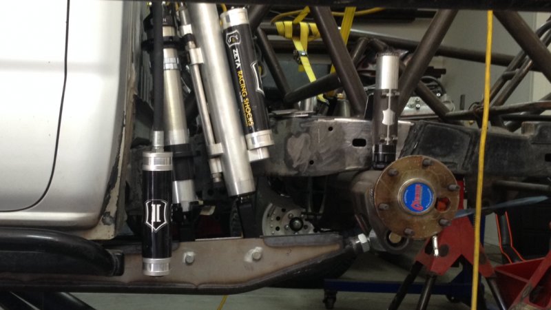

    Its been a long process but finally starting to work on the Tacoma again, should be back on the road in the next few weeks, planning on using it for a little while the weather is nice then chopping the frame at the bumps early next summer for a more functional back half.
