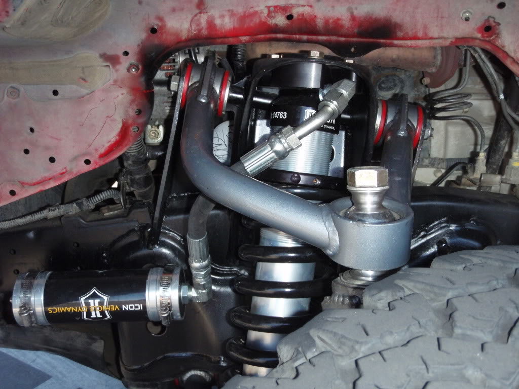

    Ive been running Icons on my 08 with a Camburg Kit and I have been pleased. My front end bumps out a little higher than most as Icon uses a shorter shock body than King or Fox but this also means that at full bump my 35s are into the inner fenders pretty good and I drag skid plate on really hard hits. Because they're shorter fully compressed Icon has to extend the shaft length as well to mirror the same extended lengths and King or Fox. My coilovers and Omega bypasses are a 9.5" stroke IIRC (King and Fox are 8") using the OEM coil bucket and a TC hoop. I can cycle 15" before the CV starts to bind at full droop/full bump, I have it strapped at around 14". I swapped my front coils for normal Eibachs slightly longer than what Icon provides. They are a great company to work with and will go out of their way to help you out.
    At the end of the day tho all "race shocks" are virtually the same, pick a color or brand and run with it, how your truck rides isn't determined by the shocks you choose but by how well you are able to tune it. No shock is going to ride like a dream straight out of the box but Icon is able to put a slightly more specific valving in their shocks as they have a ton of R&D time into the OEM replacement versions, others you will be stuck with whatever generic valving is put in them until you can revalve them yourself. FYI tho: King and Fox will be cheaper to have rebuilt and serviced than Icon and easier to find someone to work on them. Parts are more readily available.

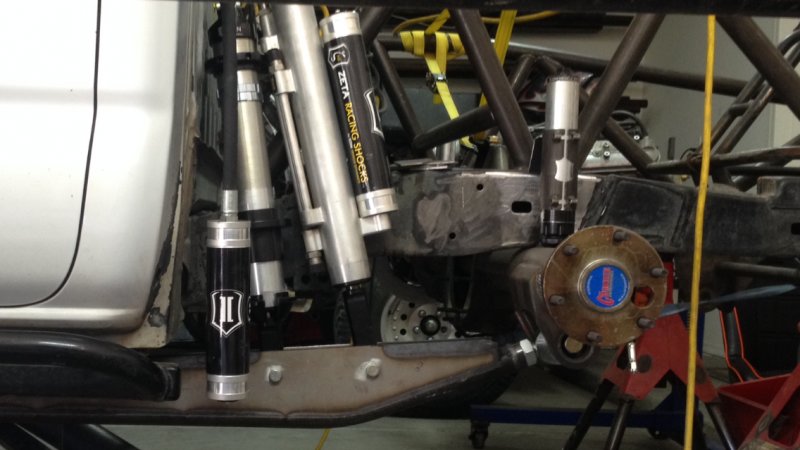

    Also using Icons for my rear end build, 14" 2.5 Remote Resi Coilovers and 16" 2.5 4 Tube Zeta Bypasses and Icon 4" bumps on a custom built 3 Link with a Camburg 9" Rear end.

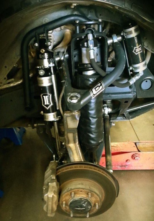

    The Digressive valving is only in Icon's OEM replacement coilovers. We have Icons that work with Camburg/TC LT kit's and are valved like King/Fox.
    The Digressive Valving setup is better suited for limited wheel travel Daily Driver/Weekend warrior applications.
    Any valving in any of the 3 can be changed if you know what stack's you want.
