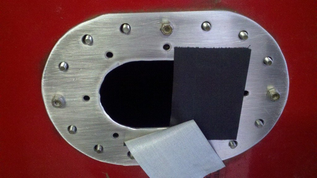

    Simple, just place everything from the original tank in to the new one just extending pick-up lines down this also includes the filler neck because they check for the restriction plate and the fuel cap test. secondly is the cell itself "some techs" will fail it for being Non-OE. paint it black or have it covered some how ( i know impossible)

    my only worry is having a few capped fittings coming out of the tank. as far as visual goes. i was planning on plating the rear cage in with aluminum plates to enhance it a bit. i supposed i could cover the tank with a top plate.

    I removed the new fuel cell fill and pick ups and made an adapter to bolt in the stock pick-up and sending unit and just need to add the fill and vent from the stock tank which is just cutting the same holes as the stock tank.

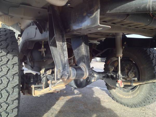

    So i just went to go mock up my tc axle shock mounts and i noticed that on the driver side of the axle theres a bunch of brake lines... if i angle them down theres not much ground clearance.. im kinda stuck guys haha HELP:help: do people move those lines? Im off tomorrow and would like to try and finish.. any one down to cruise by and help me out tomorrow?

    uhh... just a quick question.. are you bumping your suspension out before your locating those shock tabs on that axle? if so, screw the lines, re-locate them wherever they need to be so they do not rub on anything. from there, mount as per typical mounting instructions....

    Just move the lines, be careful and bend slightly in different areas and you will be fine. I cant find a pic of the driver side but you can see how mine are angled. For clearance they are just above where my spring plates are with the complete leaf pack and that allows you to drop the bed cage pretty far down too
    Edit: Here you can see it just bending up and over the shock mount
