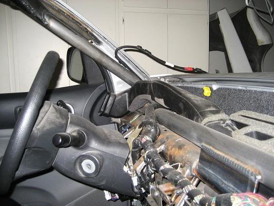

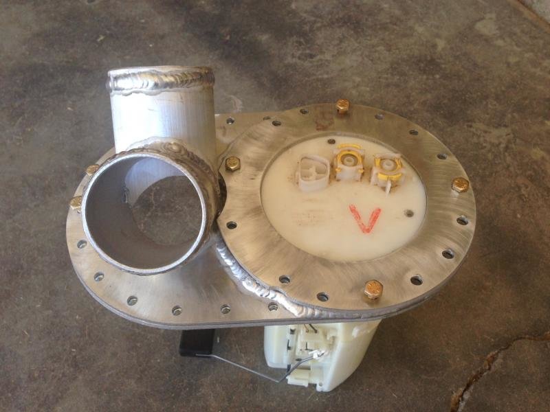

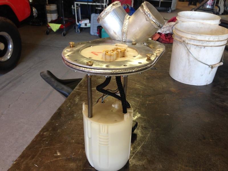

    I had heard horror stories about JAZ foam so I ordered mine without any and the bladder and top undrilled to match the plate up. With the supercharger I'll be doing the URD pump kit with a Walbro 255 and an inline filter so I could have tried it, I would really like to figure out a way to run whiffle balls as opposed to foam in the cell since they dont rot as fast but I think they will either break or impeade the float in the cell so ill be running it empty for now.
    The 32g is about 3" deeper than the factory tank so Im gunna extend the bolts and spring on the pump assembly and the rod on the float as best I can, im sure it wont be perfect but its better than nothing. Ill probably rotate the pump 180 too to get the float away from the filler neck.

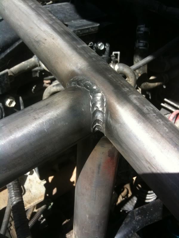

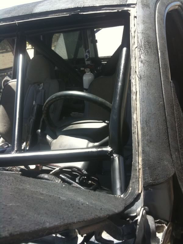

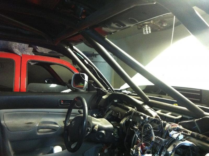

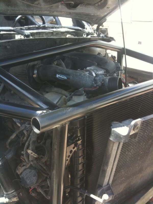

    are you tying into the factory dash bar thats back there or building another? We kinda pinched the AC vents a little bit but not enough to really affect the flow. The new dash bar pretty much blocks the defroster tho but really how often are you using it out here?
    Only thing we havent quite figured out yet is how to tie whats already built into the TC shock hoops and the engine cage.

    The schtick with foam is that if the fuel cell ruptures the foam works like a sponge and fuel won't go spraying. It also keeps the fuel from sloshing. If you are just running just a metal can you should at least run foam, and for sure roll over valves in every port. Quality foam can be had, but it's not cheap, about $85 per cubic foot. It's always a good idea to clean it well before installation- http://www.fuelsafe.com/store/foam-baffling/safety-foam-baffling-block-fb12.html
    This is how I did it-

    I'll do something eventually, just not today. I would rather get the fuel system figured out and the truck in general back on all 4 and driving again before I start worrying about detail work. Its been 7 months now since I've driven it and it will be awhile before this thing really gets driven hard. I will likely end up running the fuelsafe foam since it doesnt rot quite as quickly and trim out an area for the float to cycle. I've already thought through all this, I'm still going to look into the whiffle ball option as well. I'm thinking my only option there will be building some kind of screen/shield around the float to keep it clear but still allow the fuel to flow through. All that being said tho, of all the trucks I go out usually with only 1 is running any kind of foam in his cell and so far he is the only person to have fuel flow issues, probably cheap foam thats clogging the filter but that's what I'm trying to avoid.

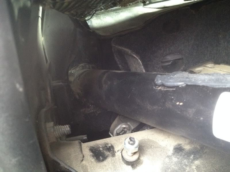

    Do you have any other pictures of how you routed the tubing around the wiper motor or did you relocate it?

    You don't have to relocate the motor. There is tons of room if you go through the triangle left behind when you cut out the inner fenders. Structurally, the cab is made to take a hit right there anyway, so it is an ideal location.
    From in the cab-
    From under the fender-

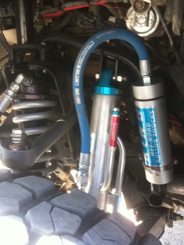

    Could do something like this:

    That's actually exactly what I had in mind. Even the flex tubing

    I shot through this little spot on my old 05 Tacoma and kept all the vents

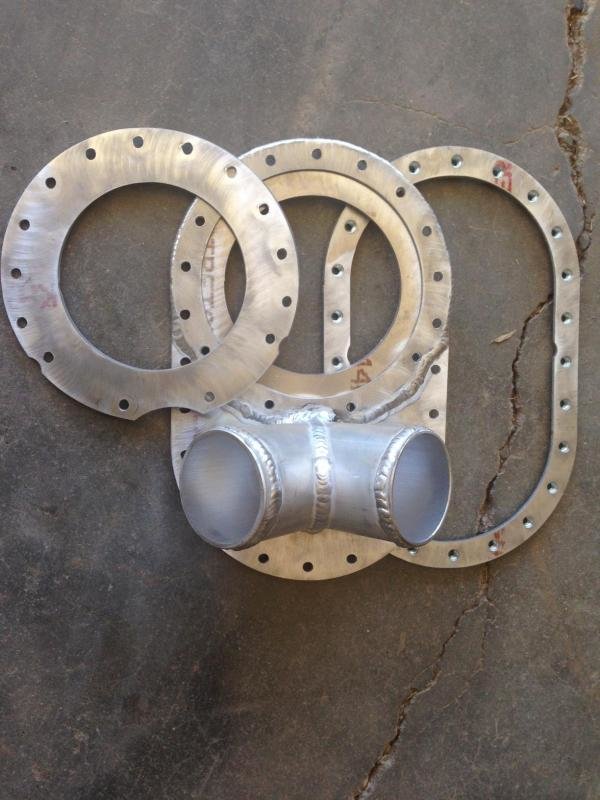

    A Few more pics of this for you guys, not pictured are the custom gasket and the flap under the filler neck. We will be selling these as a kit with a cut template, gasket, all 3 pieces, single filler neck and I believe all Grade 8 hardware for $350. I need 5 commitments to do a production run.
    PM me if you're interested. I have 2 people that have already messaged me.
