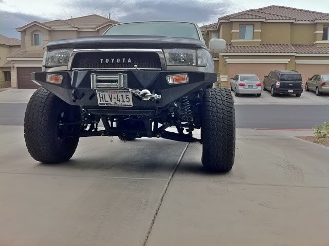

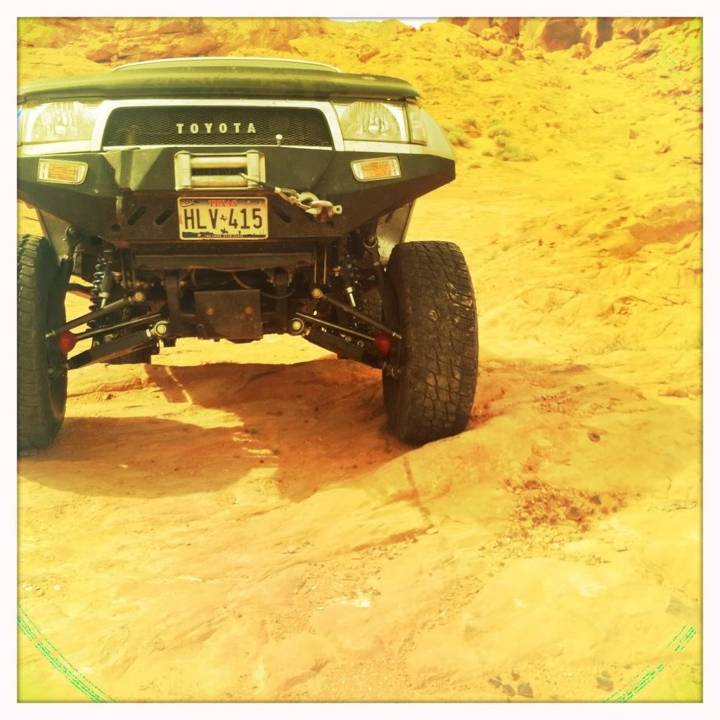

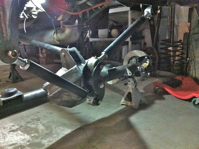

    here is the 4runner his rear setup.
    front..

    That's more on a narrower mounting point, center mount shares the same piece of metal on opposite faces, he still has over a foot between mounts, not saying it's bad, just not a true center. Looks like he just added lower brackets to mount to under the engine

    Lol thanks conman, I was lacking vocabulary and brain cells. Is it just me or does his suspension look max droop at ride height?

    that would explain it.

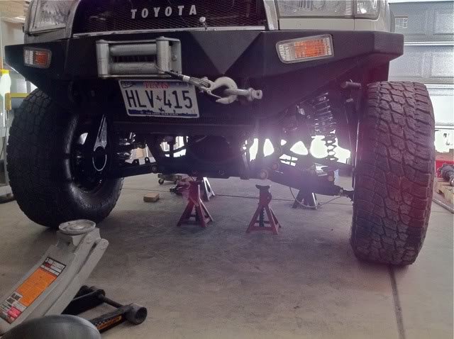

    that shot isn't ride height.
    this is ride height.

    check out the big ass heim in the spindles too...and the steering looks maxed but the lowers and cvs look ok

    It's that spindle 2mm from the tire that's throwing me off

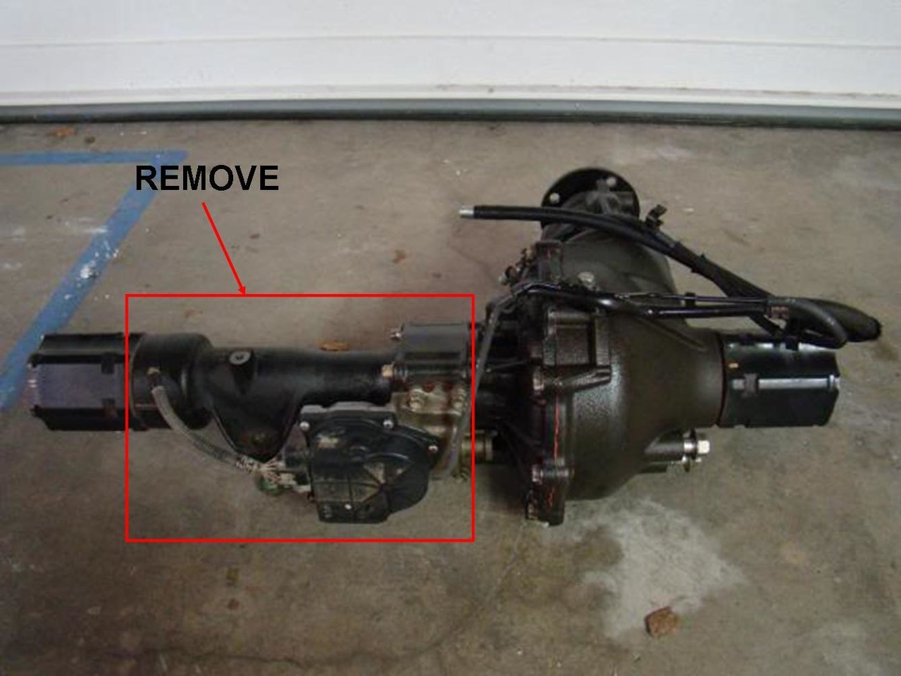

    When you center mount the diff you can add a couple inches or so to each arm length without widening your stance at all. You may not gain as much as center mounting the A-arms on a Pre-runner but you still gain some.
    That is a pic of the front diff. it is offset to the drivers side. If you center mount it you can remove the part that says remove (I actually found that pic on the internet on the first search haha) and add that much length to you arms, it is something like 6-8" IIRC. Although it would require a diff designed for center mount.
    Assuming that is 8", you could run A-arms that are +4" over and still have a factory stance. haha You could then run +7.5" arms and be the same stance as you guys currently running +3.5" kits.
