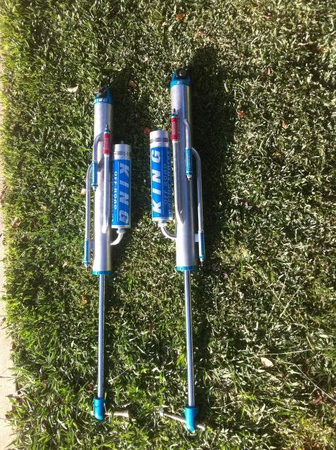

    What shocks are they? You should be able loosen the JIC fitting at the elbow and then move the hose/point the elbow in what ever direction you need and then tighten back up. But yes they will need to be depressurization.

    there king 2.5x6, doing a MT set up, heres the pics of the shocks, [​IMG]
    [​IMG] i just need to turn the fittings down to run under the UCA

    The pressure won't make a difference , the part you are trying to turn is tapered pipe theads , going to take a large wrench and alot of force

    Yep, should be able to turn those with a big wrench^^
    Mine are different...JIC fittings

    Alright thanks, one of them I need to tighten to get it under the uca and the other loosen a 1/4 turn anything besides a big wrench I should know or look out for

    Yup, nothin else. I left them kinda tight and i left them that way so you can have all the threads to use just in case but looking at it now you have room to turn. it. Either turn it when its in the mount or in a big vise.
