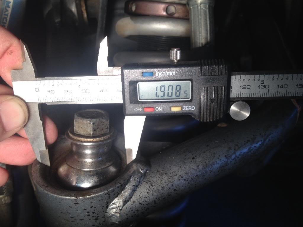

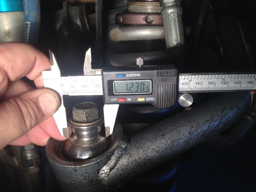

    05+. It's bigger than 1 inch, unless you mean Inside Diameter. Do you have any kits you could measure real quick so I don't have to tear mine apart? I will order both uppers and lowers if I can figure out which ones to order lol.

    just from visuals, that seems to be the same size as my total chaos uppers and i have stock replacement UCA.

    They use the same Uniball as the stock length UCA's. The 1" relates to the ID of the bearing where the mis-align sets in, if the misalign was out, then it would make more sense measuring wise... Trust me on this one. We have replaced plenty. Also, is the snap ring on the top side or bottom side in that pic? can't tell from the build up. if it's on the bottom, then the uniball race is receeded into the cup a bit.

    C Clip is on the bottom, you are right. Order placed!
