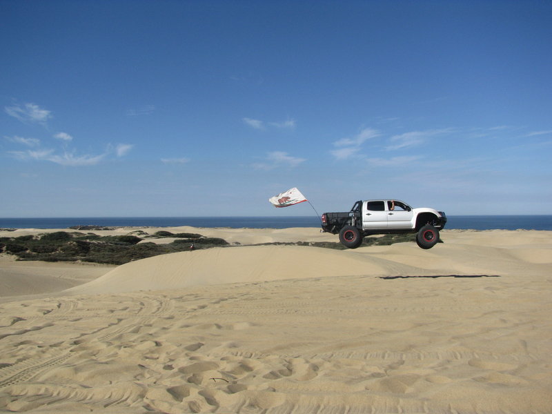

    Yeah rear is too stiff and front is too soft. Once we get that sorted out truck should handle great!
    Same jump :D
    Different day was in much better shape
