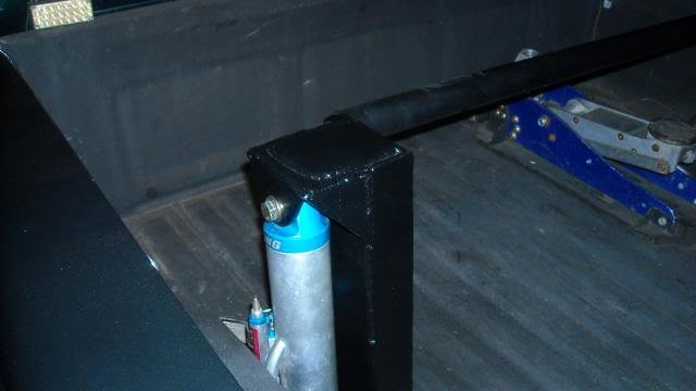

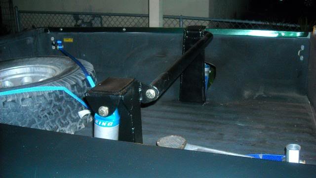

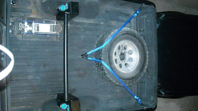

    All finished ready for testing, already got my vavling set, bumps installed, just awaiting straps.Jack mounted, tire temporarly mounted. Bolt in cross bar.

    Cool man. Id watch those tabs that that cross brace is bolted to. Not much support against twisting and side loads on those shock mounts.

    Yeah I know I may add some tiny gussets on them , they are 1/4" thick anways.
