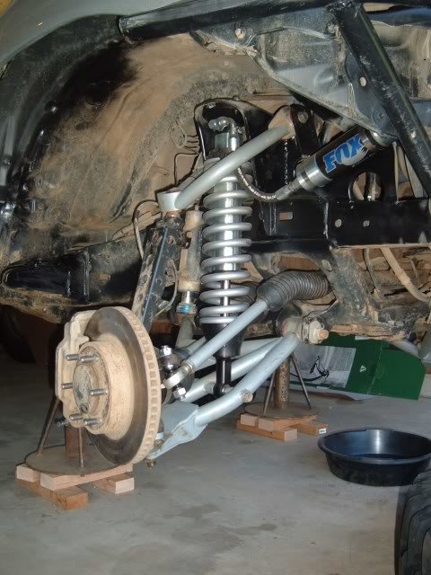

    I was running Fox 2.0 4" bumpstops which I shortened the stroke on to 2 1/4" bumping of my AP lower arms, worked perfectly. Hydrobumps were in stock location..

    Also I shortened them to 1 1/4" stroke, not 2 1/4" as previously stated.
