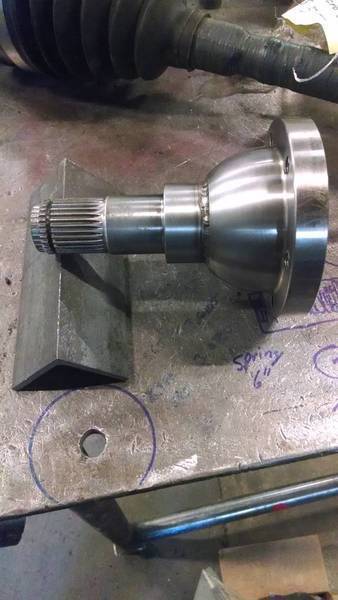

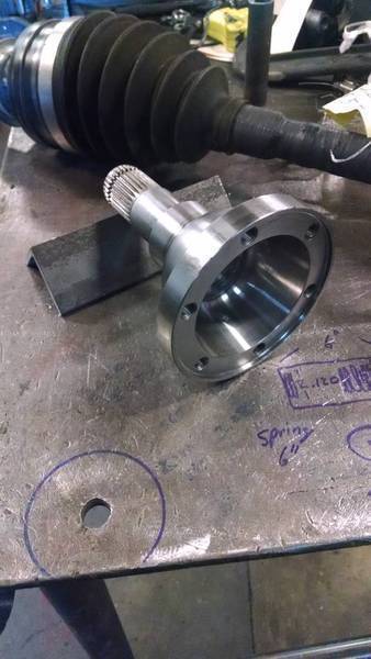

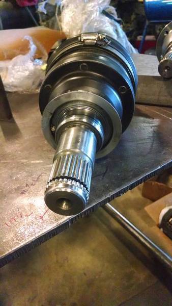

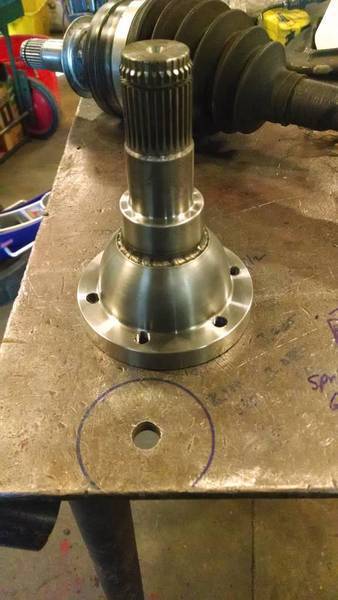

    Also we offer an adaptor to go from the OEM systems to a serviceable 9.30 CV on the inner side of the axle, they sell for $135 each if anyone is interested you can contact us here on TW, email us at engageoffroad@gmail.com or call the shop 909-238-6788.... Engage

    Here are my CVs using the Engage 930 conversion adapter:
    Any 930 CV off the shelf from Kartek will bolt up. You do need a custom axle that mates to the 930 Inner Race and the Tacoma outer CV though.

    Benefits? Stronger? More travel?

    That's pretty cool man! Hey, where did you get the axles and are they 300M? Cost?

    Engage made the axle but most axle shops will be able to make them as long as you give them dimensions and spline count. Hand them a 930 inner race, and hand them the Tacoma outer CV, and give them a length, they should be able to make it work.
    I believe it is 300M
