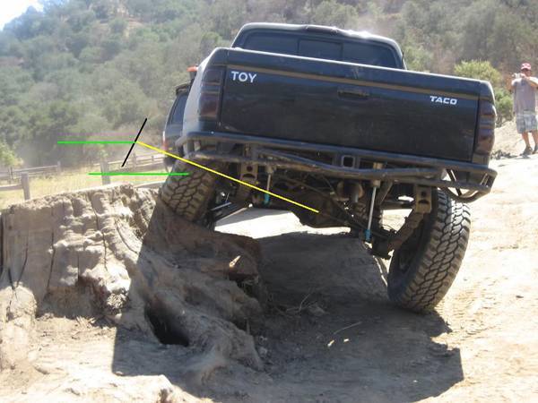

    Did you cycle that on the main leaf? Your going to be bumped quite a bit below the frame with where your shocks are, when you bottom out the driver side at the same time its going to drop the axle farther down on the side you see here. With your shocks inside the frame you should have a more shaft left when flexed like that
    Edit: look how much shaft is left here with the wheel pretty much buried and Jason actually found his shocks were mounted too low

    He did not :rolleyes:

    hehe I used you to demonstrate on the edit

    Nope, but the shocks are pretty much maxed out when it is at full droop though, so the only way to fix it would be to run 18's, but I had already picked up 16's at Tim's recommendation that they would be plenty for what I was planning.
