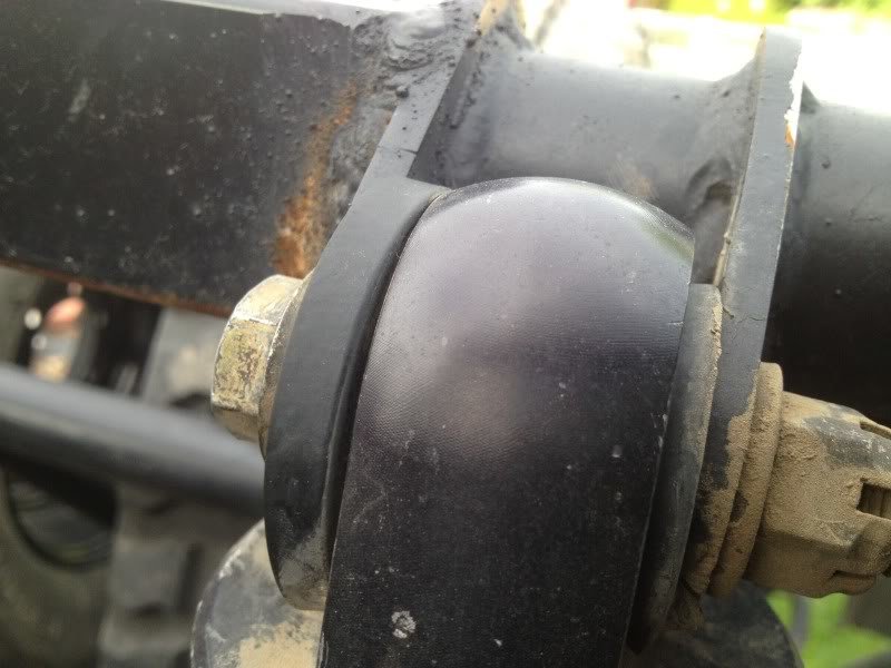

    Warning: Graphic hillbilly engineering depicted in the following photo.
    I got tired of the clicking and removed the uniball from the shock end and used half a bushing to insulate the frame side of the bypass. It actually worked, and is pleasant to drive again. I have about 10K on them miles, no problems so far.
