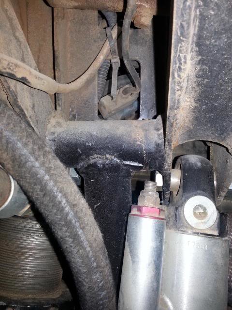

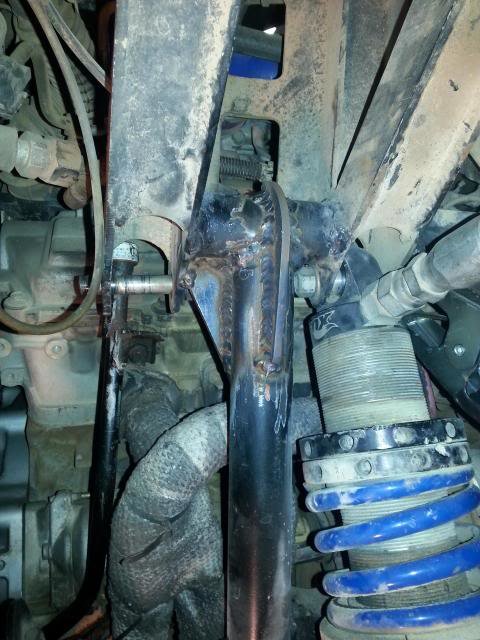

    Everything
    Fuck my engine cage. Had to tackle some cracks last night before heading out this weekend
    Before
    After

    Man you are having bad luck with that! are you getting coil bind?

    the way mine is built i cant get my upper arms off.... so i need to do something about that. and i have already cracked my mounts, and re welded..
    i need to re do my engine cage to do it right :(

    no coil bind. my last set of coils were pretty damn close though. It's because of the shock angle and motion ratio. the shocks don't have enough leverage. I'm running 800 lbs coil with tons of preload and ridiculous valving. My truck runs great in the rough but the setup isn't all that efficient.

    wait what? you cant remove your upper arms? I guess it's not often that you'd need to but still...

    Ya not sure how you can't get your stock uppers off with the OME shocks
