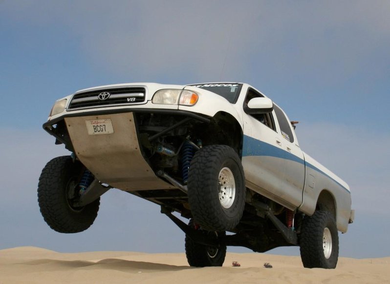

    My buddies early Tundra with 4x4, TC, linked and FULL bed. Tows his race car (7open truck) or his small toy hauler. 10+ years of off-road and Baja trips. My 4.0 still pulls it though.
