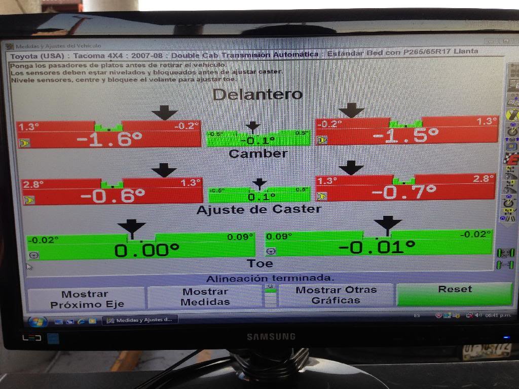

    That caster is bad...I went from -3 caster to positive 3.5 so it is possible....gonna have to play with the heims though...back heim in front heim out=more caster

    It's going to be squirly on the freeway
    Nope just adjusted them

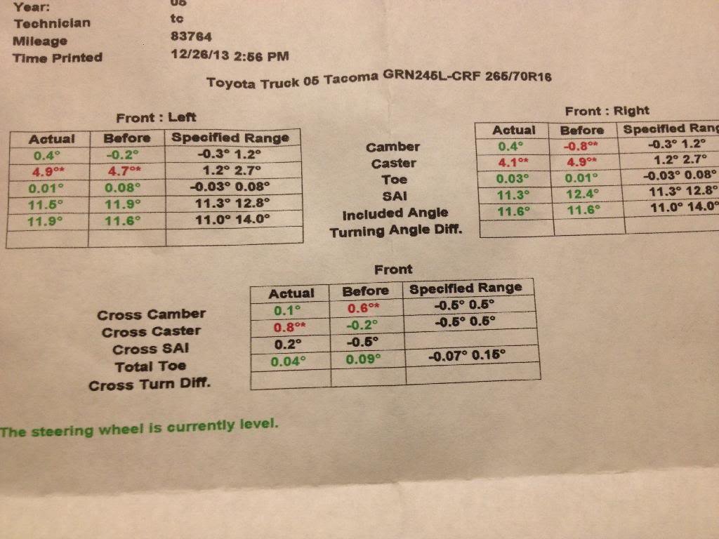

    Here is my alignment sheet from my last alignment. After this it went dead straight and was finally a joy to drive again. Since then (note date was before the Baja 1000) it pulls to the right and needs to be realigned. This is on a 3.5" TC kit with upper heims. Note my caster is at 3.4*.

    So an increase in caster from 3.4* will make my truck LESS twitchy?

    I would say so
