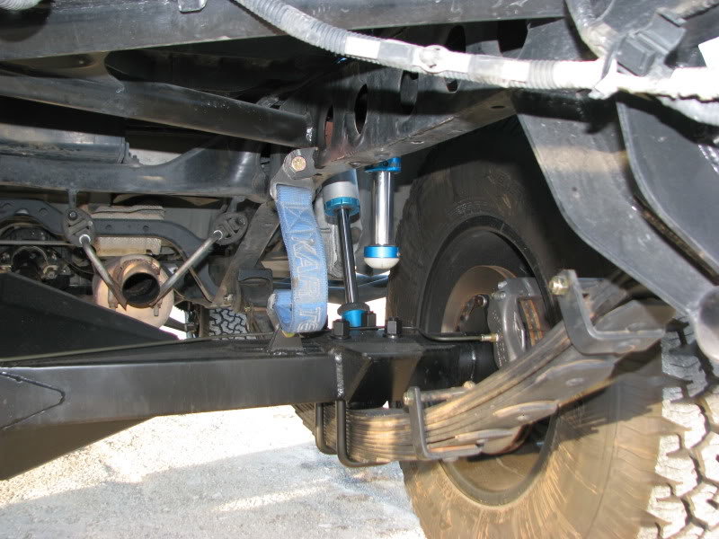

    mine are just two tabs. nothing special

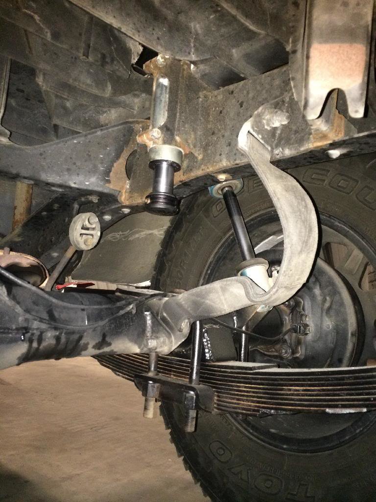

    This was my old set-up. We used two tabs on the bottom and the top. Running the straps like this was a suggestion from Tim @DMZ. It keeps the straps away from the shocks at ride height so that you dont need to run bungees.
