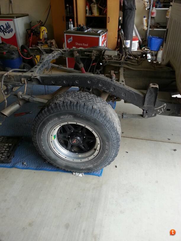

    how much of the bed is left? or did they ditch it completely? gotta love their work, so clean.

    Aftermarket nuts and bolts

    I want to know how they smog that thing if they drive it in CA (custom tank?)... Because if there is a way I am going with a similar setup :D

    My baby keeps getting new work done. The new owner made her BA.
