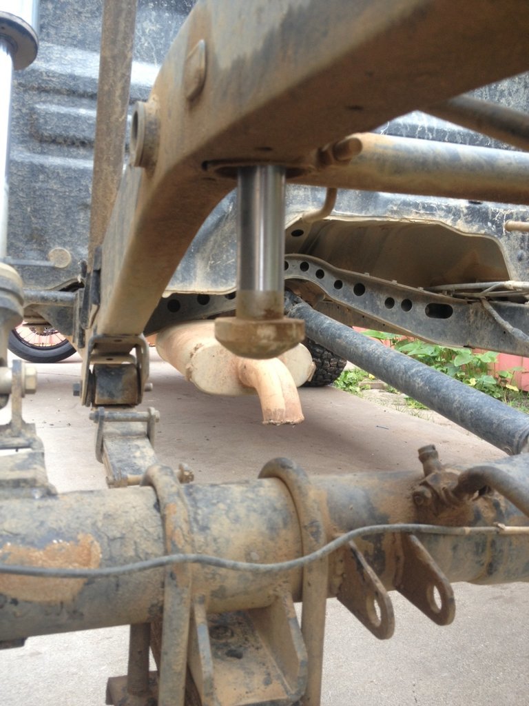

    yeah this was what i found. i was hoping for a large plate that covers both u bolts and welds to the axle outside of them, but im not sure they make that. that way theyd be protected, and i wouldn't chew through delrin pads

    Put up a pic of what you need, and where it's hitting

    he needs one the goes over the u bolt though, cause the bump hits the ubolt...same with my truck lol

    You would probably have to fab that up. Or modify one. I think these fit in between the ubolts.

    you could cut it down...just pick up some 1/4 steel and cut it out...like how jordans is.

    yeah i'm just trying to avoid grinder time but it seems it is inevitable

    So your bumps are bumping off the axle?

    indeed, as depicted in the photo. which is why I am in need of pads. also need straps too. currently trying to get all of that squared away

    Just make sure you build it so that you can still get the u-bolts off if you ever need to.
    Some of my biggest fabrication regrets involve a "good" idea, 15 minutes, and a welder; and end up taking hours to deal with whatever I overlooked at a later time.

    Something like this is probably what you are looking for
    Unfortunately I cannot help you in finding a set like these as they were already on the truck when I bought it.

    Those look like a set of leaf spring perches welded together

    Yep exactly like that actually
    Think that that will clear the u bolts though?
