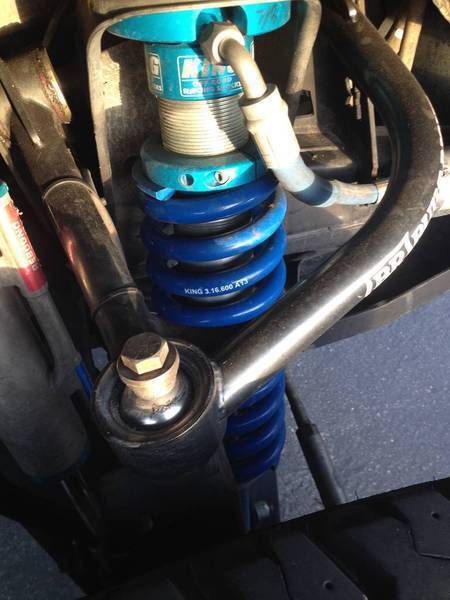

    My kings are 16" 650lbs coils and I have much less preload than you Gabe and sit much higher. Something seems off if those are truly 16" coils.

    Jordan has same 2.8 x8 but with 16" coils wich is strange because they both go all the way to the top of the shock.almost like my coilovers are longer than 8s lol.
  10. Apr 23, 2014 at 9:39 PM
    anthony250f
    anthony250f Well-Known Member
    Feb 18, 2012
    #73066
    16,774
    Anthony
    San Diego, CA
    2008 dcsb trd offroad 4wd
    jordans 16" coils
    my 18" coils
    and heres how they were before spindles

    Aren't you engage? If so, your running a regular 8" which is longer than a short body 8" which has an external top t cap which takes up threads
  17. Apr 23, 2014 at 10:07 PM
    anthony250f
    Feb 18, 2012
    #73066
    16,774
    Anthony
    San Diego, CA
    yes i am...got my shocks from dsm though...i do remember them talking about the top caps for jordans 1st gen.

    You have regular 8" shocks, I posted that before I saw your other pictures. That's why you can fit an 18" coil easy

    Gabe I have 3.5" with 600x16.0" springs and weight you should be fine with 16" and the front end weight you have.
