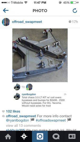

    Someone is selling a 05'-up TC kit with shocks n something else on ig... :notsure: don't remember who though :)

    It's @ryanlbogdon not sure of he's on here too. $3500 with co's, bypasses and bumps
    If I was in the market I would hit up ^^ that guy DTF for his new kit!!!!

    Yup, your pretty much getting the coilovers and bumps free lol bummed I don't have the cash right now

    dam great deal! wish it was +2. lol with the 3.5 I'll be getting stuck on the trails I drive through.

    Could always turn around and sell the kit and keep the coilovers bumps and bypasses then buy a 2" kit, kinda a hassle but it would save some coin
