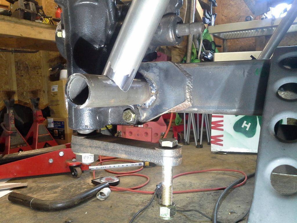

    Ya'll know engine cages better than most, got any constructive criticism on what I got so far?

    thats a lot of leverage at the front down tubes. reason you're not landing them on top of the frame ?

    Just a question. Why didn't you land the tubes on top of the frame, rather than the little stub tubes?

    I'll brace them as much as I can, the only reason I didn't put them on top of the frame, is because the Toyota IFS steering box sits on top.

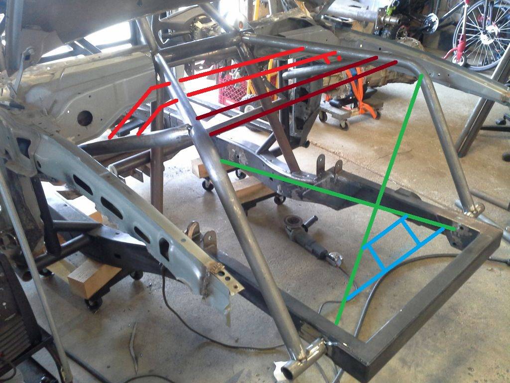

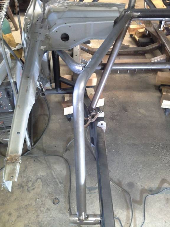

    Some more pics for a clearer idea of where it's going -

    i would shit can the stub tubes, and box off the frame for a landing point for that down tube if you have to go that route. where else were you planning on running tubes ? MSpaint that shit.

    also, in the 2nd pic i can see at the floor boards on the passenger ( as well as the driver side) you have your A pillar tube coming down off the frame a bit as well. box the shit out of these areas. a hard hit at the right angle, could sheer that tube off the frame.

    It's already a tight fit, but yeah, I could probably cut off the stub tubes and build some mounts. Any reason I couldn't just gusset/reinforce the shit out of the stub tubes?:confused:
    And this is basically what I had in mind -
    Red is shock mounts, plus removable crossmember. Dark red is the option #2 for crossmember location.
    Blue is mounting location for the winch (basically mounted upside-down to double as a suck down winch), made with plate or tube... I don't know yet.
    Green is welded in bracing. Radiator fans would be located on either side of the X.
  13. May 16, 2014 at 11:50 AM
