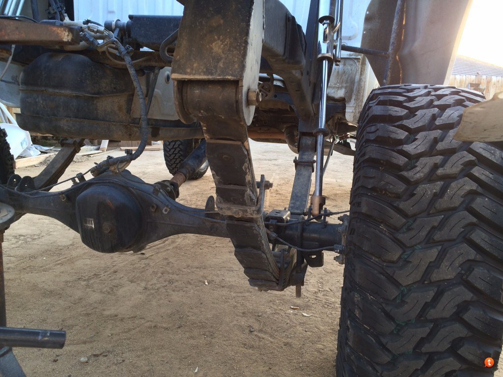

    I hate to interrupt the awesomeness that has been going on but I need some guidance..
    I have the 50t pack and I fabbed up some 12" shackles..
    My dilemma..I sag..bad..so besides re-arching the leafs..can i also increase or decrease my shackle length to achieve less sag?
    Thanks in advance guys!!

    Pic is while truck is jacked up..
    Also..installing 2.5" dia. 18" stroke Kings..so revalving can help too right?

    What is your weight situation look like?
    Your shackles should be a lot straighter at full droop.
    My 12" and 50t drooped but I was very heavy out back. I spoke with Deaver and we determined I needed my shackles to be clocked closer to the cab.
    I switched to 13" and it helped .5/1" but finally switching to a custom shorter length pack fixed all my issues.

    Weight is only 2 spares and some tube work..
    I was thinking I need to make a longer shackle

    I found that after a couple years, even with a re-arch the 50T wouldn't hold up to the weight I carry. I ended up putting in another leaf between the third and 4th leaf from the top with some wicked arch in it. I also removed all the pucks and plates and hand chamfered each leaf. I'm sitting with ~9.5" up and 7" down now.

    A longer shackle will only do so much. It will swing your shackle angle away from the cab causing a little height increase as well as preload the springs. This will increase the spring rate and harshness more than height gain.
    If I was more patient I probably could have done what JBerry did. It would have been cheaper than a full new pack.

    ...too much shit to list.
