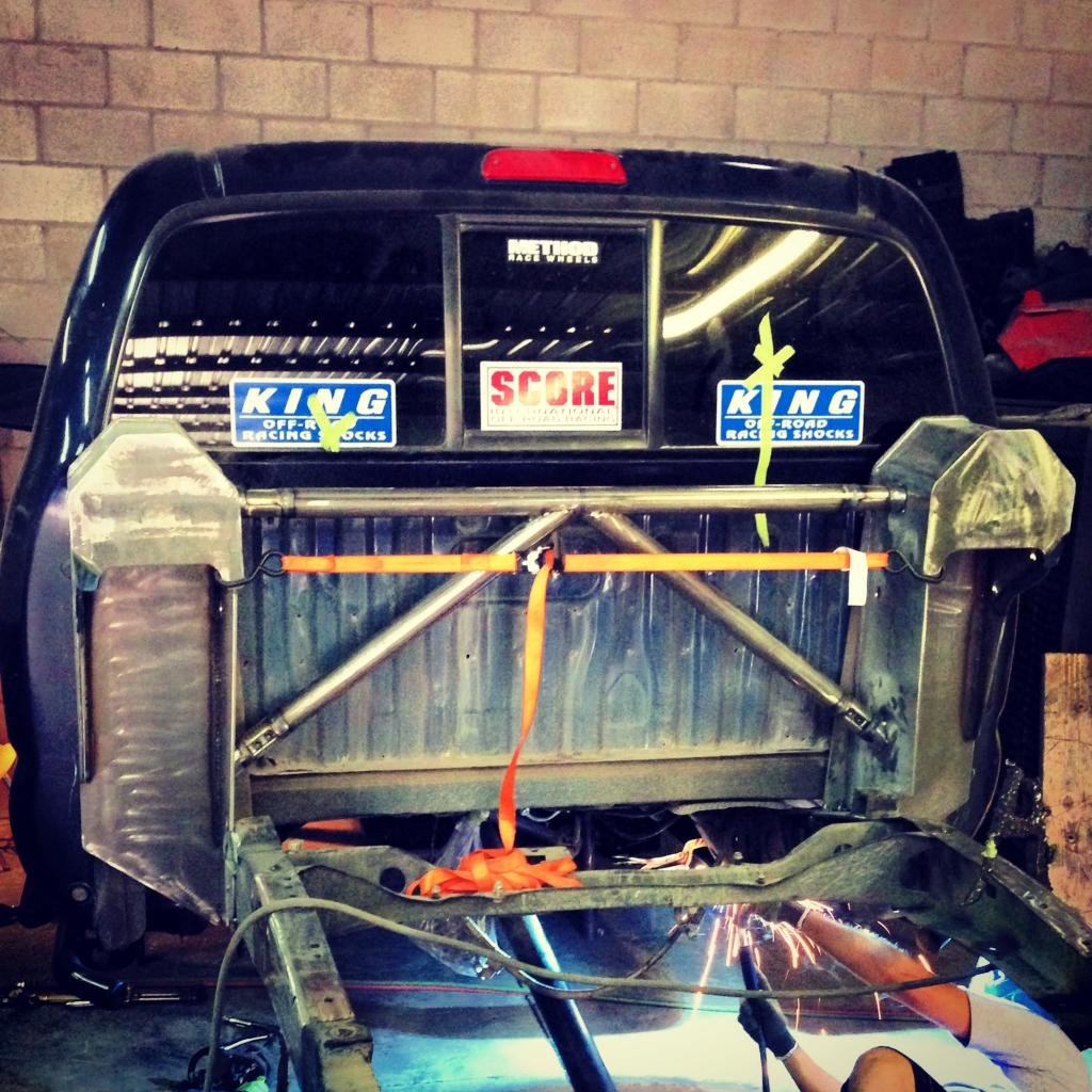

    Almost finished with shock towers, what do you guys think?

    I hope you plan on connecting to the frame in a lot more places

    are you gunna plate the frame while you are at it?

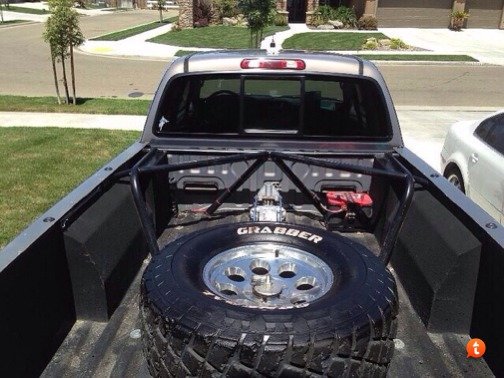

    They will connect the cage to the frame, how is yours connected to the frame?
    Yup, where lower links mount and bump stops

    6 places

    I'm trying to wrap my head around those massive plate shock mounts, but can't come up with anything. Gargantuan is an understatement.

    Got to be honest this whole trend of plate shock towers has me completely baffled....

    Nice, how are your shocks mounted
    haha, they are massive shock towers
    whys that?

    Shock Vaults, as it seems.
