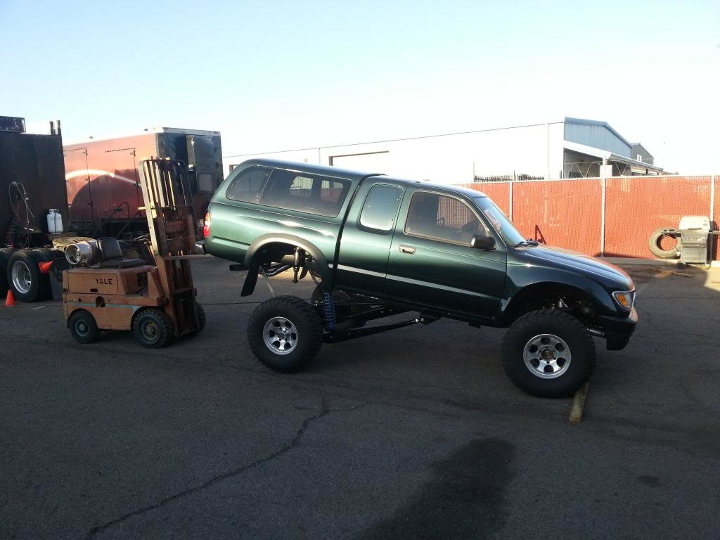

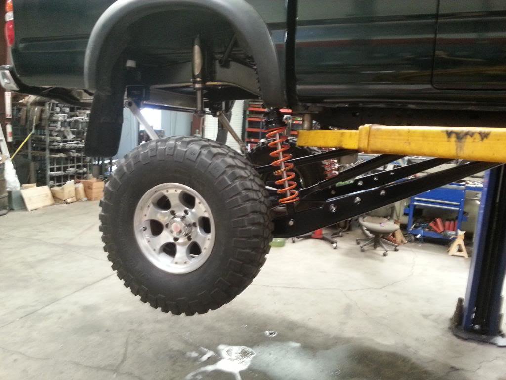

    Why does everyone clutter their bed with cages? I like the under bed challenge. Nothing in the bed but a spare. I see some ridiculous things people create with tube and most of it isn't in structurally critical areas.
  6. May 29, 2014 at 4:24 AM
    Tommy2spd
    Tommy2spd Member
    Apr 16, 2014
    #127851
    6
    Not talking shit, I know how much work gets put in to projects like these.Every time I do one I swear I'll never do it again, but that never happens. This is my 97, double cab bed on a extra cab. 24" in the back. 10 up 14 down and absolutely nothing in the bed, the bed unbolts and comes off. 14" shocks with no limiter so they're 15.5" of shaft, mounted 18" forward of the axle. Used a Tundra rear diff. 20140427_180750_zps3f357b33_a3e6f08c61820669880b713ce2d9b1421e3d3729.jpg 20140413_140042_zps650816ee_1c18d8d14048ee80761757b03e6ebf67cf7c2572.jpg

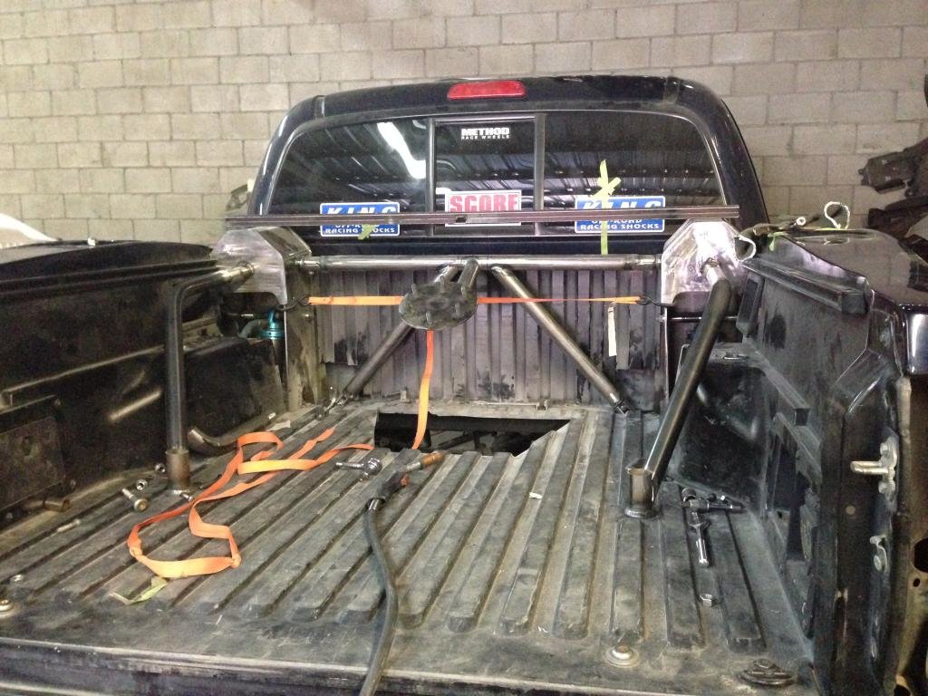

    Relocated middle tubes so they weld into the frame and boxed the frame

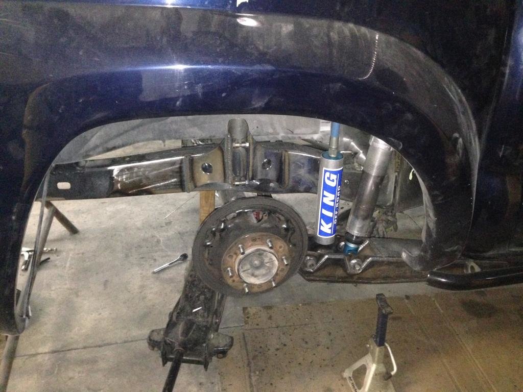

    do you have any under bed shots?
    im confused how you dont have shocks going through your bed

    looks like its a shock hoop angled toward the rear, and i think the shorter rod ends and placement in the wheel well may be how it doesnt poke through

    Is that stock bedsides with mud flap still? How u run a tundra rear with stock bedsides? Is there a build thread on this truck somewhere or more pics? Very interesting
